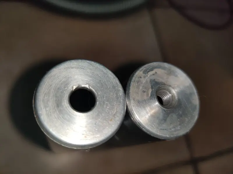

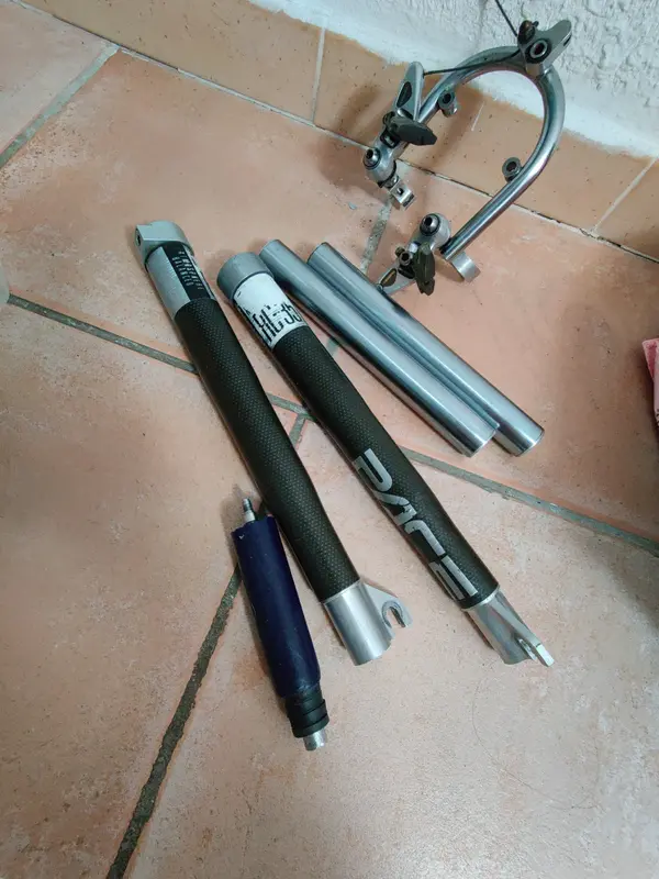

I was given a Canondale M500 bike with a Pace RC35 fork on top I have 2 problems with one of the threads in the tube and it has come off.
and the other problem is that I have the fork that remains at the bottom, I took it apart but I think the person must have been tinkering with the elastomer.

I would probably try a helicoil thread repair for the damaged thread. You can buy a kit cheaply enough and DIY.
From your pic it looks as though there is no thread at all in one side, and nothing to helicoil. This will be a problem as you need both sides to have the elastomer stack.
On the subject of elqstomers, there should be a stack of 2 each side that are usually a light brown colour, separated by a plastic spacer. There is also a bump stop elastomer each side as well (usually black).
If i were you j would contact forum member 'justbackdated'. He runs a business servicing and looking after pace forks. He used to work for pace before they sold out to dt swiss.
He often sees threads like this on here and responds but best to message him.
If you are a new member I think you need to have a certain number of posts before you can private message anyone though.

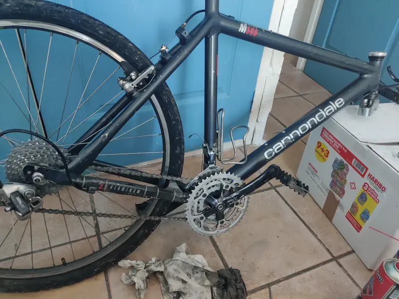

In the meantime I can show you the bike I was given... I thought it was pretty and I didn't want to throw it away.
