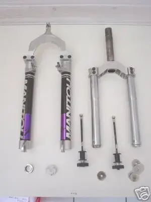

Slim, thanks for the info (pics not working by the way)
The ones I am really interested in are the 2s, do you know how easy it is to get spares / elastomers for the sports and the 2s?
What are those last ones you pictured?
the last ones are the manitou comp

just found a pic of the internals of the manitou 2 ............
looks like you will need a long allen key ...........

You do need a special allen tool for the Manitou 2's. The old importers of Manitou's have loads of NOS bits for them - including elastomers - i'll dig their details out - I got some bits from them recently.
