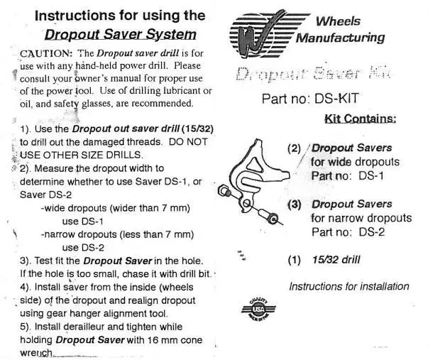

this any good to you ?
https://www.sjscycles.co.uk/accessories ... ch-hanger/
Dropout savers are great and very easy to fit. Helicoils are more fiddly and best left to a pro but will leave the frame looking like new. If you’re getting the frame resprayed, talk to the guys at Argos. They have done many, many RC100 restorations and their paint match is superb, they also do frame repairs meaning you can get both done simultaneously
Ive had to use the dropout savers on a few frames, make sure you get the right length one though, i had to get longer one for the carbolite as the thicker alloy dropout was too thick for the usual one, tbh it was only a quid dearer, £7 very well spent
