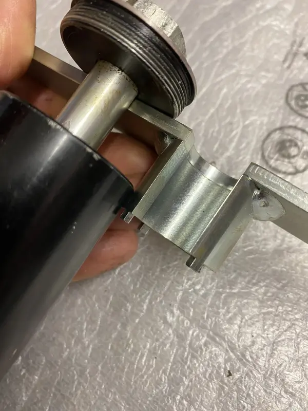

I recently picked up a Cannondale Silk Adventure with a very poorly Headshok Ultra.
I was told I would need a HDTL146 to remove damper but these are no longer available so I bought a Bitul FK072 which apparently is a copy.
It arrived this morning but it doesn’t fit🤬.
Am I using the right tool and that I just need to somehow pull the top cap further out or have I got the wrong tool? IMG_4189.webp

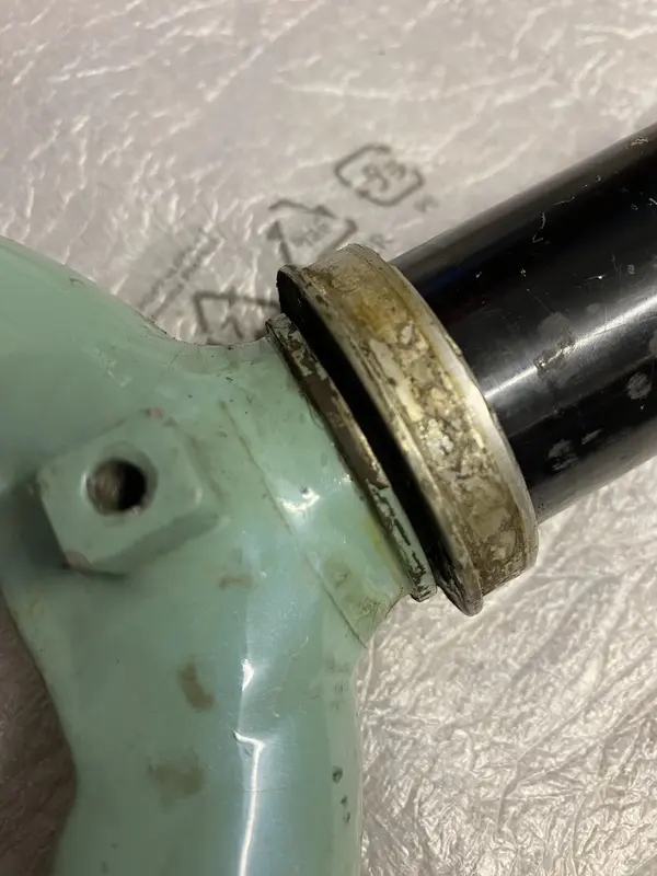

You can buy replacements, but the shims come in different gauges and mine were so rusty I wasn’t sure what size I needed (I couldn’t measure), so rather than making an expensive mistake I sent it off for servicing.

Great work with the tooling.
My experience of headshok is that they always look like that inside🤣
The travel isn't very progressive, so if you're used to a standard fork, they feel wierd, like they travel too far.
Good luck! We used to keep those shims in stock to step the head tube back down to 1&1/8, then fit RS or Marzocchis👍
Depending on the ID of the spring you might be able to firm it up or tune the progression with elastomers slipped inside. Ideal? No. A way of making it do what you need it to do?
