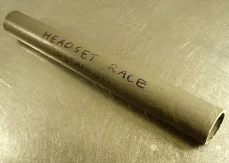

A great way to install fork races is an off-cut of inch and quarter plumbing pipe...
Oh, and a f-ing big hammer :lol: :lol: :lol:
