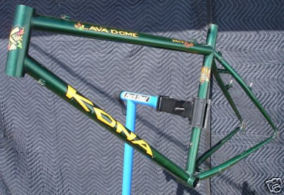

doesn't look like that one - there's no bulges of any sort on the frame itself - it's a 94 kona lavadome, there's some pics of one at http://www.retrobike.co.uk/forum/viewtopic.php?t=75607
or same frame but a later model:

oh and thats a 97 lava dome
ignore me i should learn to read :oops: :oops: :oops: :oops: :oops:
if the bike pictured in this thread is your bike then it is 97 , im all of a fuddle now :? :? :?

Edit: Charlieboy - sorry for the confusion, mine's a 94 lava dome, I was just looking for a pic of the head tube - ignore that pic!
