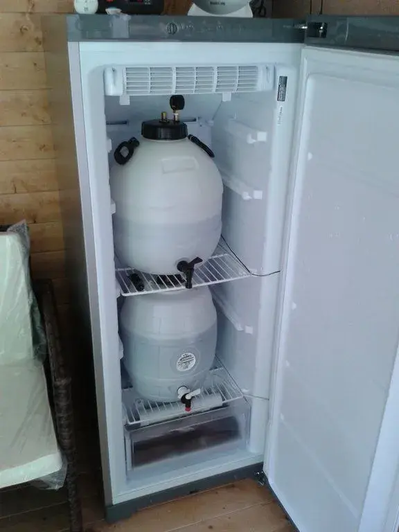

Tried something different with the Wherry. After 7 days in the warm for second fermentation to take place I then put it into my kegerator* at a constant 12C. Conditioning took less than 6 weeks and it has produced a beautiful balanced beer.
*My kegerator is a freezer with the temperature control over-ridden with an adapted aquarium heat controller.thing is good.

Can you provide more info and pics of your Kegerator please?
Keg me baby one more time! Sundew on top and Wherry on the bottom. The white bar at the bottom is a small greenhouse heater for when the cooler months come around. Temperature of the controler is set at 12C. The controler is an STC1000 which is built into a purpose built unit to regulate cooling and heating. Temperature sensor is in a glass jar filled with water.
Same as this
Did you build the temperature controller yourself or buy it?
You can buy the unit as a whole like I did or buy the STC1000 seperate and build it into a fridge / freezer. Some vids on youtube explain how.
The only small problem I had was disabling the freezer temp alarm but easily solved by locating the piezo speaker on the circuit board.
