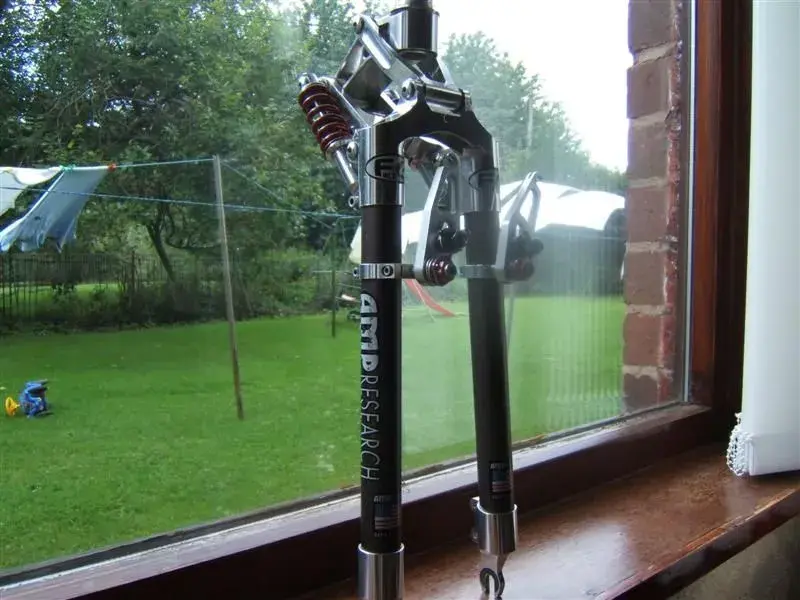

My F4 that i wish [really really wish] that i hadnt sold it on.After all the renovation work and outlay for a far out fork
Shit :cry:
Here it is to upset me further :(
