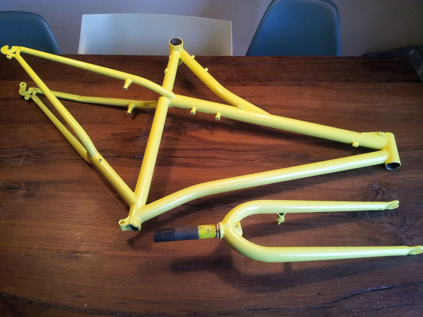

Picking up the newly powder coated frame tomorrow as well. Getting quite excited :-) :-)

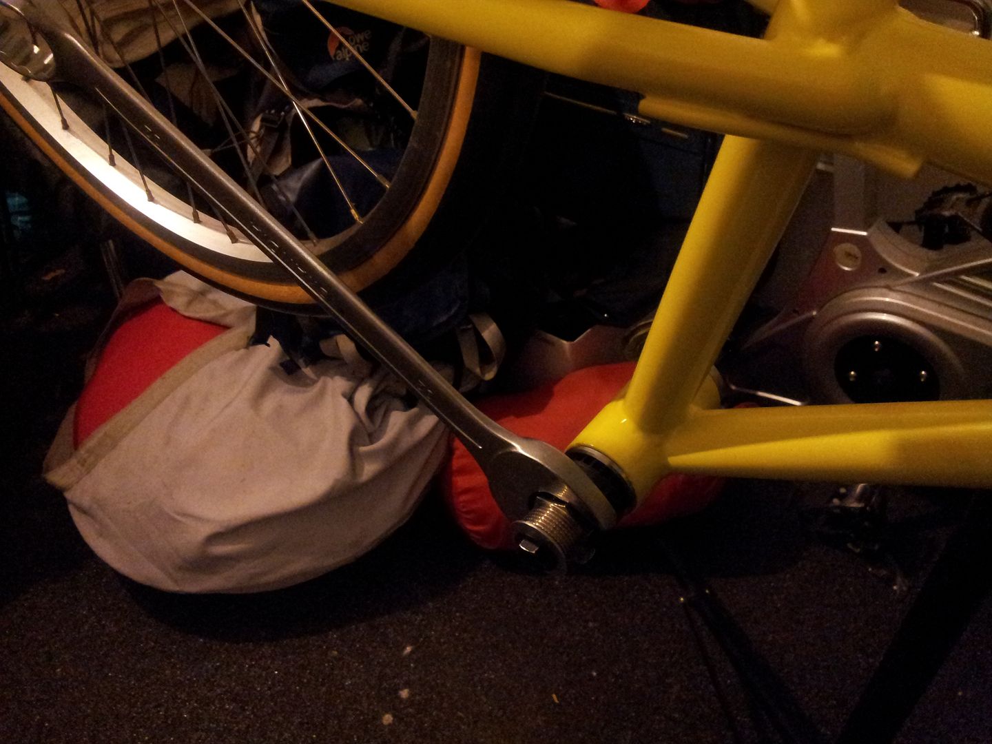

My hack for keeping the bb tool in place during assembly and removal is working well (inspired by the great lgf thread on this topic). Just a low profile bb tool, some space nut thing found from the local hardware shop, couple of big washers, and a spare crank bolt. Then I use the biggest size 32 wrench I could find... not let me down so far. Shiny new bb goes in with no problems and no risk of the tool slipping and damaging the shiny new paint.
Your BB tool ... 'arrangement' (I don't want to call it a bodge as it's so nicely done!) looks remarkably similar to mine :wink:

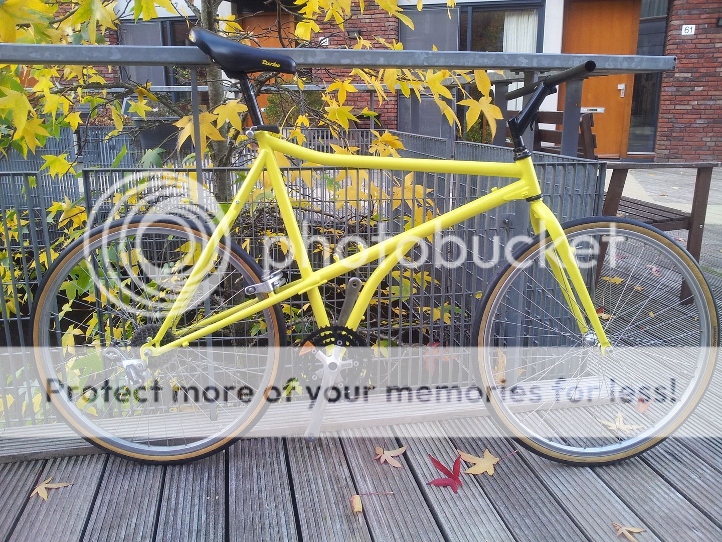

A quick photo of where I am as of today.
In general I'm very pleased with the quality of the powder coat work. Nice even work, no problems with frame bolts, headset or bottom bracket. For some reason they did not mask off the brake bosses. Took me quite some time to get them cleaned up to get the u-brake moving nicely. Found that the best thing was to work with just the arm, the retaining plate and a bolt (no spring). Then just work on the boss until the bolt and retaining/spacer thing can be firmly tightened on to the boss and the brake arm can move freely.

The black looks great against that colour, really like it so far 8) Think I'd prefer blackwall tyres (and proper tyres!), but that could change as more parts get fitted...
Look forward to the big decal moment (no pressure :lol: )!
I have to say I agree. Put it in the living room this morning to "weigh up the job so far" ... It will be getting blackwall mtb tyres very shortly. Just need to see what I have in the garage :D
