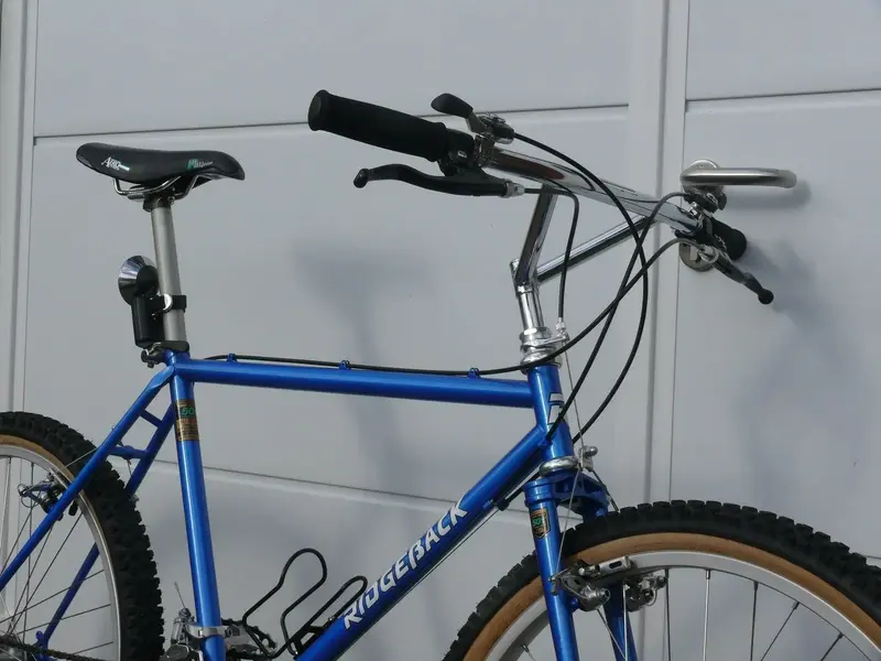

I should explain that before building the wheels I had checked to see if I could fit on such a small frame
My preferred bike size is 30"/30" by this I mean crank c/line to top of saddle is 30" and top centre of saddle to bars c/line is 30" This bike
measured 25"/24"
The bike came with its original fluted alloy seatpost ( SR Laprade ) and Madison saddle. The saddle needed to be at least 5" higher
and the bars a similar amount further forward. A new seatpost solved the first problem, however the finished bike looks slightly unusual
in that extra long seatposts were not often seen on 1986 bikes
The additional height/reach required for the stem/bars proved more difficult. It seemed that the best/only solution might be a set of
Bull Moose bars. At this point I decided to proceed with the build hoping to locate some bars later
It took more than a year until I found a set of Nitto bars on eBay USA. The bars gave me the exact height/reach required for a perfect
fit, though I must admit that this was pure luck
The same eBay seller also had a pair of NOS Shimano SL-MT50 gear shifters of which more later

The Ridgeback 501 came well equipped for its price ( about £ 380 ) in 1986
The cantilever brakes, four finger brake levers and large flange hubs all came from the then top of the range ( for Shimano )
Deore/XT/Deer head groupset 'Built to withstand the demands of off road riding and the rigors of touring' as it said at the time
The only compromise was in the drivetrain. Here the lesser AL-11 series components were used, presumably to save money.
So we have an FD-AL11 and RD-AL11 (front and rear mechs) operated by SL-MT50 shifters
All these items were present when bought, though the LH shifter was partly missing. I was tempted to upgrade the cheaper bits
to XT, which would have been easier, however I decided to stick to the original spec because both the mechs cleaned up quite well.
The shifters were another matter as they were inherently quite flimsy, and it took a long time to find some NOS examples
The new bars and shifters made the brake levers look really shabby, so I could not turn down the chance of an NOS pair on eBay
( this time from Norway )

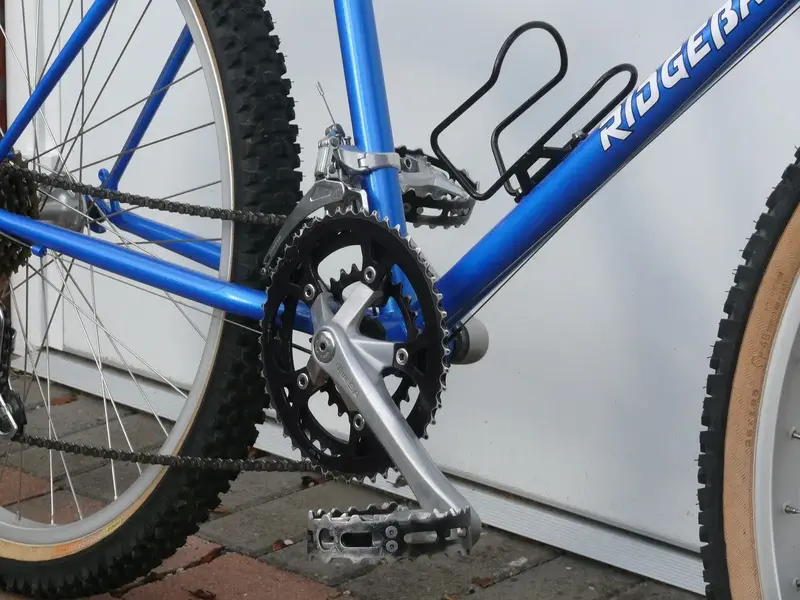

The photo shows the front mech area in some detail. The FAG bottom bracket , chainrings and cranks that came with the bike
are visible with some Suntour 'bear traps' as an upgrade from the plastic pedals it came with
If you look closely at the chain stay, just in line with the rim, you can see a faint line. This is a paint protector made from three layers of
self adhesive clear plastic ( Fablon ) you join three layers together and then cut to a suitable shape, warm up slightly and apply to
the stay. I use a single layer on the lower side of the down tube to protect from stone chips

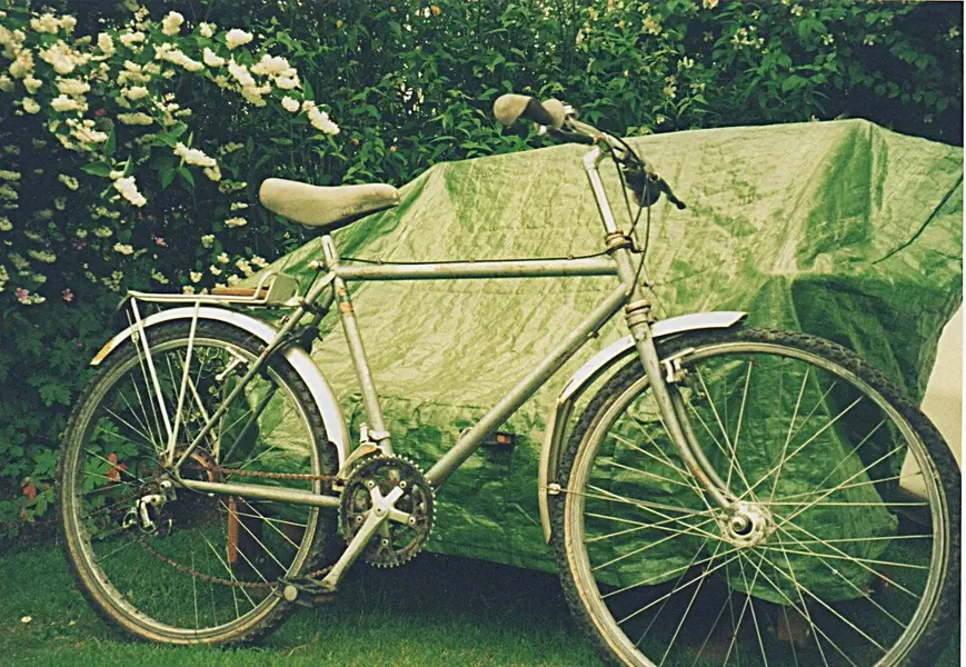

This is the bike as bought
It looks like it came from the same field as yours James
The extra high and short reach stem gave a very upright riding position much like a Cleland ! I had to replace it so that I could
ride it and also bring the bike nearer to its original spec
The headset was the only major item that was discarded, apart from the rims
The Madison saddle was in quite good condition when cleaned but was changed for a more comfortable one

Re: Re:
Haha! Yes, your does look in similar state to mine! You've done an amazing job it has to be said - well done. If I can get halfway close then I'll be happy. I do like the blue you have used though - is that a RAL colour?
I found someone else on here with mine: viewtopic.php?f=6&t=311662 and it contains a bit more about the spec. I think i'll have trouble finding the original front triple though (Tracer crankset).

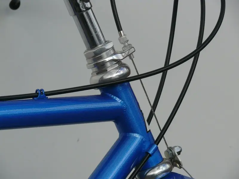

This last photo shows the new alloy Specialized headset in some detail. It replaced the very rusty chromed steel one, and brake hanger
on the original
I like the brazed on cable guides either side of the head tube, its a nice detail and not only stops the gear cables from wearing the paint
but also makes the cable runs from the shifters neater. The cables are in fact on the 'wrong' side and cross over under the down tube
The TIG welding is particularly neat
