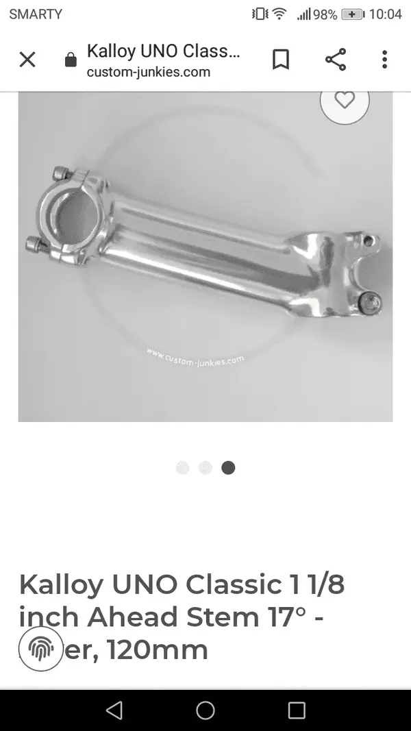

I think I might have found a suitable stem, that's a Kalloy, seems like great value 17° rise 120mm length

Most Kalloy will be fine, nothing fancy and rebranded by many.
You'll find them as UNO (a Kalloy brand), Club Roost (of I-beam fame) etc.
What year are we looking at and do with have suspension forks.
But try a few out and see whay style you like.
