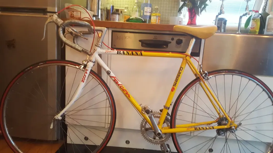

I have got a Team Banana Falcon bike that needs new tyres Which are Gum Tyres
Does anyone know where I can buy them from, either online or in East Sussex & how I should measure them to get the right size as I am guessing that they would be a special order.

Many Thanks for getting back to me Hamster. wasn't sure where I was going as there was no tyres on the bike when I got. but I think it is the 622 that I need to get.
I will let you know how I get on .

20220813_190711.webp 20220813_190715.webp once again. thanks for the help. in the end I went for the tubular tyres with the stick on gum tape. Almost ready for the road, just need to do the chain and the handlebar tape. Cheers, Peds.
