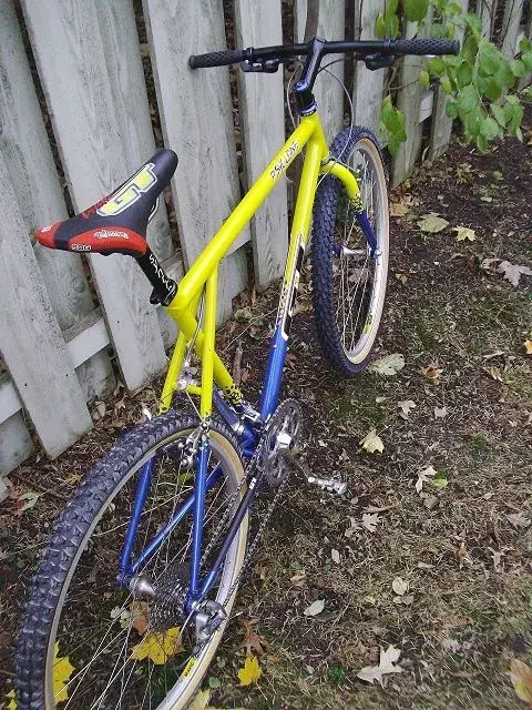

GT Xizang
Very nice choice...
If you need some suggestion... here is mine :-)

gm1230126":1obrf2n5 said:
note canti hanger
Thanks :D
I'm pretty sure, you know it much better than I do.
The canti hanger on my Xizang were installed as early as 1996 and the models of 97 and 98 have that too.
Actually I had already collected a few nice xtr m900 parts...
but I think I'm going to change a bit my concept. The shiny titanium needs black parts...
