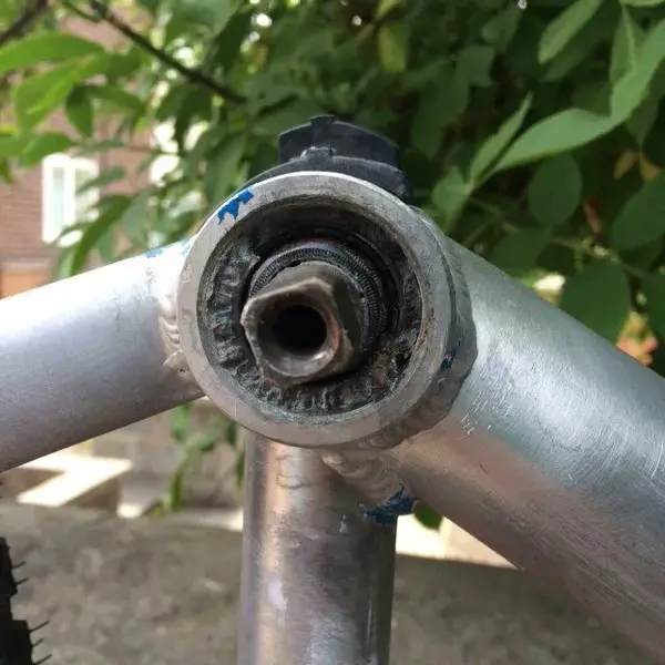

Bought some cheap v brakes to put on it for a fiver off shpock with a kronos seatpost. from the spares bin I have a single speed conversion kit that got bought and never used and a tiagra crankset, also a cheap tin of copper hammerite off shpock, just need a bottom bracket and some pedals, the high spec would have taken too long so its all out ghetto for this just need to remove the existing bottom bracket and probably get the shell chased and faced,
The bottom bracket is in tight though
this is the plastic side of the bottom bracket
