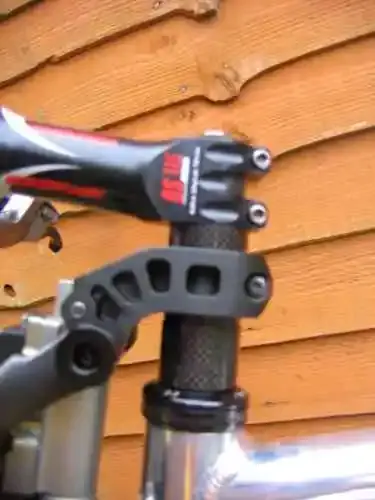

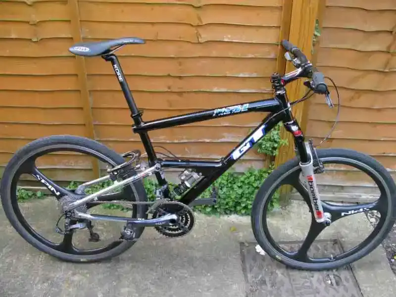

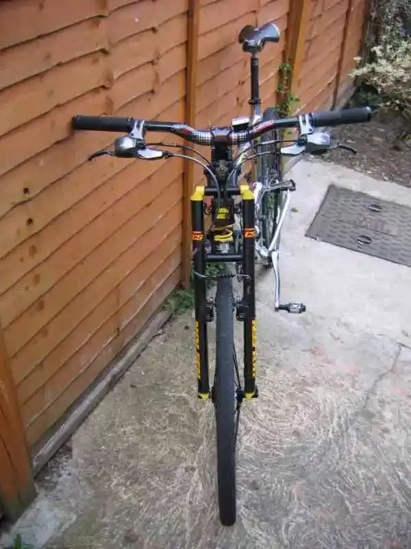

In answer to a request, here is a pic of my second RTS - similar build to the first, but with older XTR group set, spin wheels (yes, they are commuter tyres on there, but this is not a commuter bike) etc. Since the photo's I've changed the forks to some FOX F80 RLT (setting up the Marzocchi was too fiddly, and sadly a huge waste of money as a result). Awaiting new decals from Gil, so this should tidy the frame up nicely. I do wish I could get away with using some carbon crosslink forks that I have, but due to the linkage, the lowest that I can put my stem always feels too high. I've posted an old pic of my other RTS with these on as well - comments welcome.
