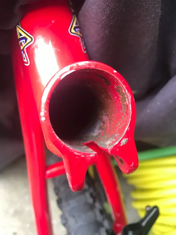

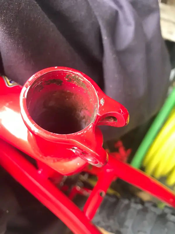

Can someone advise me please on seatpost sizing?
I have I believe a 1997 GT Karakoram frame. It has 1997 stamped on the forks and I presume these are original. I looked up the original spec in 1997 and it says a 26.8mm seatpost.
I have measured the internal diameter of the seat tube at 29mm (not with calipers). This feels slightly too big for a 26.8mm seatpost - how much will the seat tube bolt clamp in the tube? Does a 26.8mm post sound right?
Second question - The tube has an integrated clamp, I've yet to find a bolt that will fit through it as most bolts appear to be 8mm and it looks like I need a 6mm bolt. Any advice on a suitable bolt I should be looking for?
TIA
Damien

Seatpost has to be MAX 0.2mm smaller than the seat tube inside diameter. Ideally the seat tube slides in smoothly like a piston - with a nice clean seat tube like yours, that's what you should aim for.
The best way to check is with a conical seat tube gauge; GOOD bike shops will have one. You can try to measure with a vernier, but it's still a bit on the trial and error side.
Many thanks for the advice, much appreciated.
