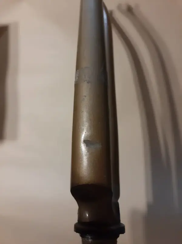

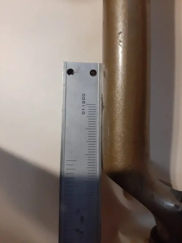

A teaspoonful of rust mainly from bottom bracked and stays, three dents and some surface rust. Any expert opinions about the roadworthiness of the frame? Does the dent on the fork look bad(structually)?

No opinions on the fork?
It doesn't look too bad, so long as it hasn't put the blades out of alignment. If they are chromed I would just leave as is. If painted I'd probably fill the dent and repaint the entire fork.
