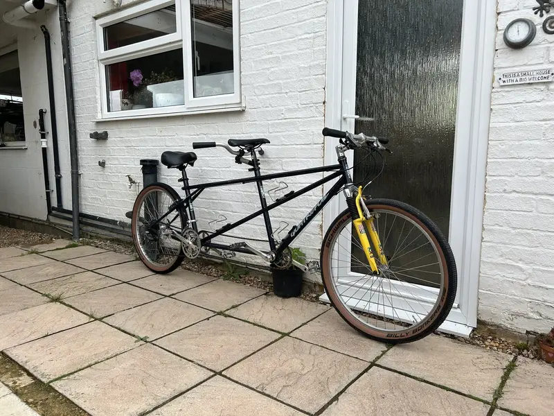

Been a while but time for a quick update.
Still got this and we all still enjoy riding it once in a while. Went to pull it out of the garage for a ride last weekend and found the front tyre flat. That was enough motivation to freshen it up a bit, had a spare Billy Bonkers hanging around so put that on and ordered another for the rear (arrived/fitted this morning). Also fancied chucking on these quadra 21’s to see if they’d work. Need to take it on a proper ride to see but the 2.1 tyres are much nicer than the pasela’s 1.75.
Might do a few more bits to it soon too.
