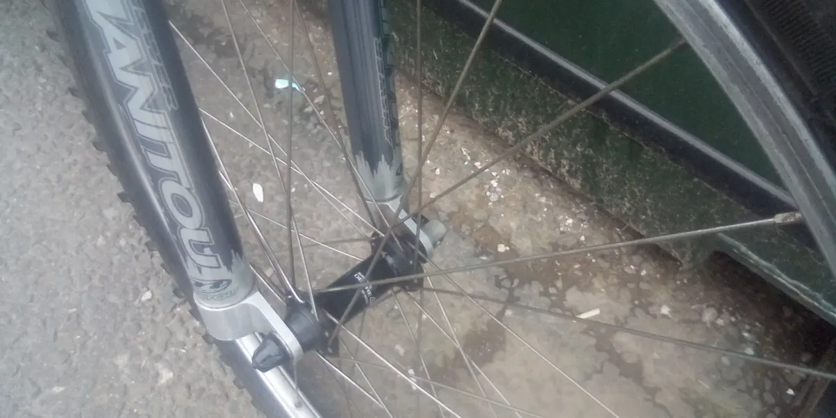

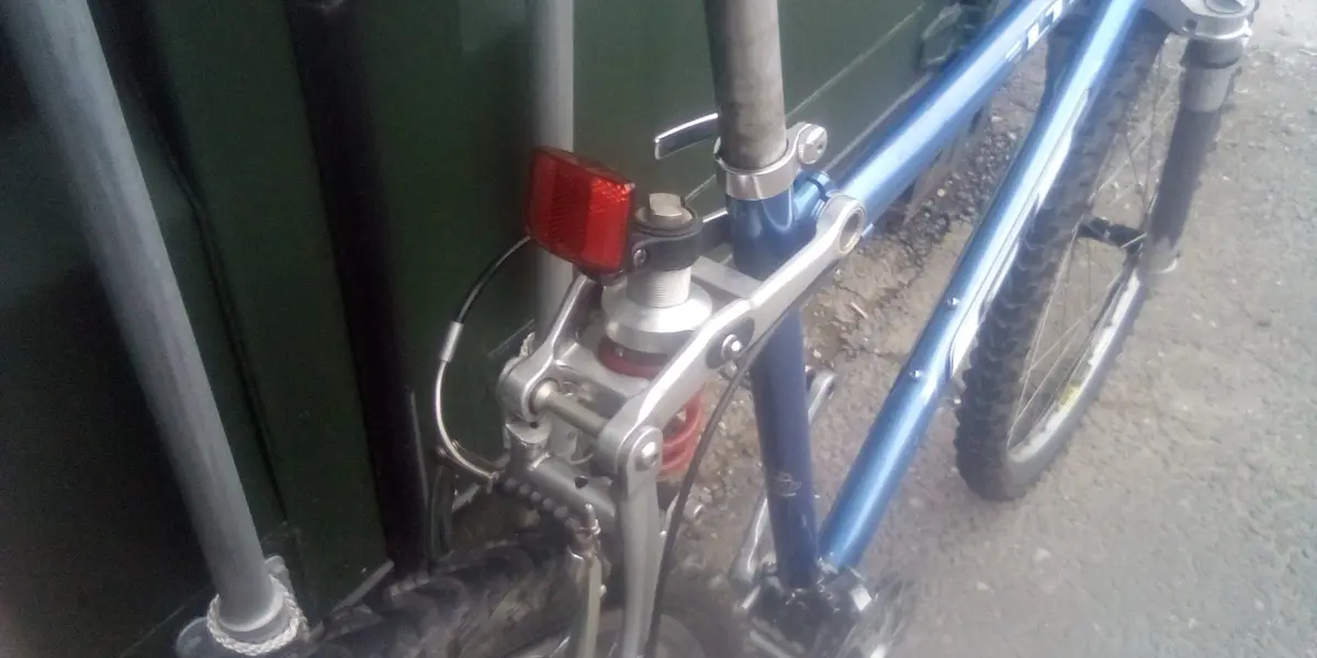

Does anyone know much about these I think mines more or less original it has a black lx brake on front silver v brake on back which I think the back is wrong and the forks are manitou comp which are wrong so does any one know original spec frame num mt80705599 which I don't understand it's cromoly cheers
