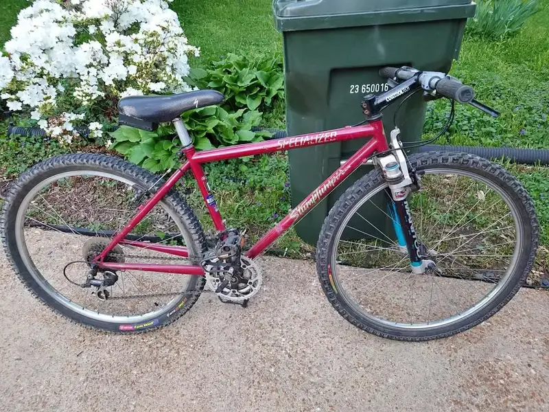

So, I've arranged to buy this Stumpy (pretty cheap), but I haven't seen it in person, yet.
The seller does not know, so, any guesses as to the year and subspecies?
I can't see the mechs clearly, but it has an LX crankset with black arms, cantilever brakes, and that Manitou Three fork.
Hard to believe the fork is original, but who knows?
I'm guessing it's later than '94, because of the steerer, but I bow to the superior knowledge here, as to exact year 🤔
Not an original fork.
Black LX crank would suggest it's a '93 model - in 'Plum Burgundy'
Front end of a '93 would have been threaded headset and rigid fork, but that could easily have been changed.
There's a chance it could be the '94 model in the optional 'Blood Red', which had a threadless rigid front end - but then the crank arms should be silver.

Of course, once you gave me the clue, I found loads of '93 photos, in that color - It was the fork that confused.

Thanks for that link - A clear difference between '93 and '94, and mine is pretty def. a '93, even the old saddle is a match :)
OK - I have the bike, and I'm sure you all were dieing to know :
Serial # 92F371 - So the frame was made in Feb '92, and the bike sold as a '93.
AND, it indeed has an 1" steerer - Which makes it more problematic to change stem length, if I keep the fork
But it looks like some work-arounds out there, so shouldn't be a big deal :)
