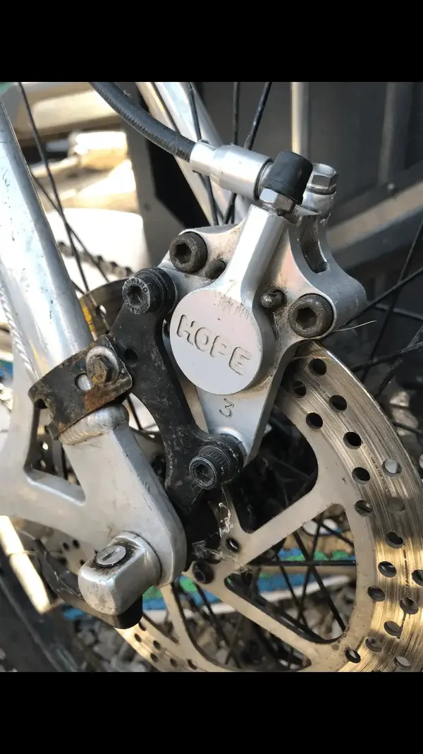

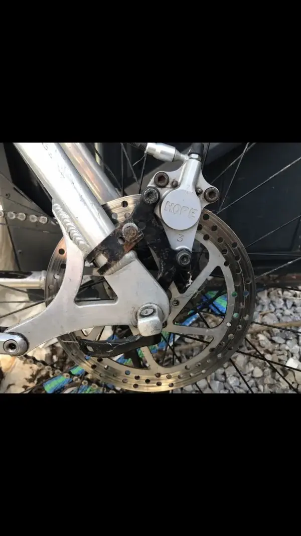

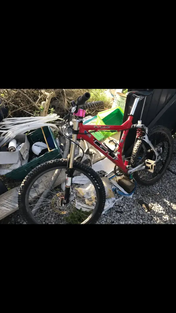

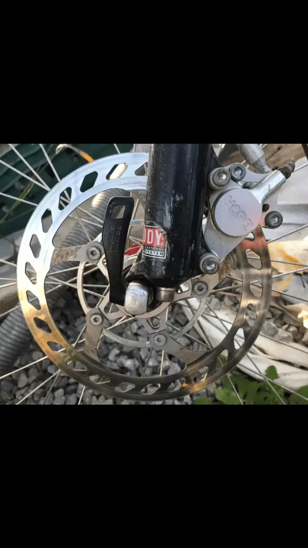

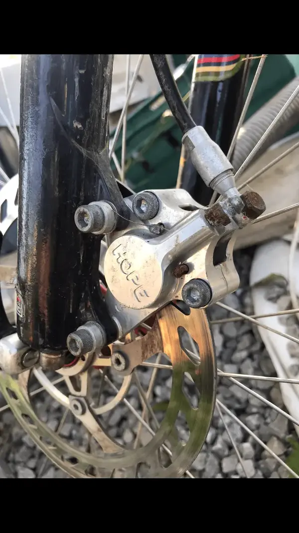

Hi All,
As promised pictures of the red lts with the disk brake set up.
