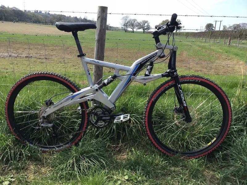

great thread, already posted my new (to me) JW-4 in another thread but here it is. Need to find some different shocks, front is noisy and the rear has no damping at all, other than that it's spot on!

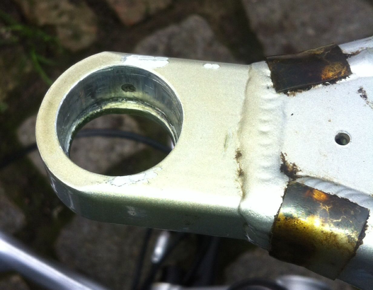

The bearing lives in a machined recess in the lower wishbone, the recess is shown here with the bike upside down. Note the flange against which the bearing rests, and through which the suspension forces are transmitted;

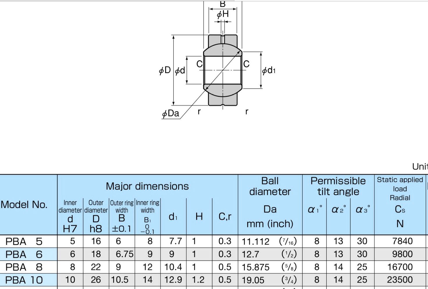

The bearing that lives in there should be a plain spherical bearing type PBA10, that looks like this;

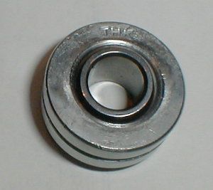

This is an odd bearing indeed. Its a compound bearing, one inside the other. The two parts on the extreme left and right are the parts that Whyte provide to connect the fork to the inner element of the spherical bearing. The bolt goes through the middle and clamps it all together. In the middle is the spherical plain bearing, as expected, but with a far larger centre bore. The pieces either side of that are inner race halves of a normal angular contact single row ball bearing. The balls should live between the groove that these parts make when joined together, and a matching groove that lives inside the spherical part of the main bearing... So what we have is a high speed - low load ball bearing sat in the middle of a low speed - high load bearing.
Yep, I'm scratching my head too... The high speed capability isn't required. Possible reasons for fitting it would be to reduce friction when steering, but it comes at the expense of an even more fragile bearing that fails in an even more spectacular manner than the type I was expecting to find. There were a number of balls I didn't find in there, so at least a few have escaped. The amount of clearance the failure of this as yet unknown bearing type generates when it fails is spectacular, the bike would be utterly unrideable.

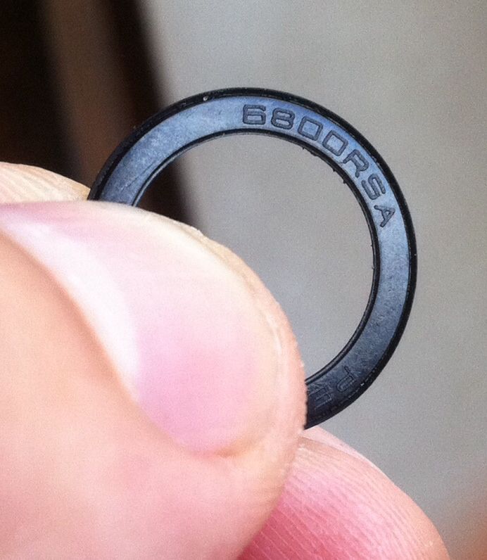

So what sort of bearing is it? According the the dust seals I salvaged from the greasy mess inside the bearing cover boot, its a;
6800RSA From PEEL in China. Except it isn't. The 6800series bearing in peels catalog looks rather different to this one.
