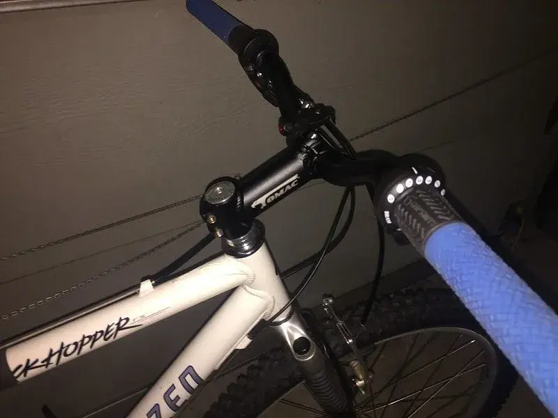

I like Gripshift. My '97 Rockhopper came with them and I'm still using them. My bike has SRT-400i. The brake levers are Dia-Compe DP-7.
As for grips...I cut the ends off my original grips many years ago when I wanted to try bar ends. Recently I was trying a few different grips (no more bar ends). I tried ESI Chunky (my favorite grips on my single speed street cruisers) and Lizard Skins Charger Evos. The ESIs didn't seem right; the Lizard Skins felt nice but at 140mm length they were way too long. In the end I found Sram Racing grips. They come in 60mm, 110mm, and 130mm lengths. I went with 110mm and I'm really happy with them. Really comfy, they look great, and are dirt cheap for some reason.
ESI Chunky...130mm length (with a bontrager bar plug :confused:)
Lizard Skins...way too long at 140mm, plus the blue didn't look right.
Sram Racing...110mm is great. I think 60mm would be too short.
