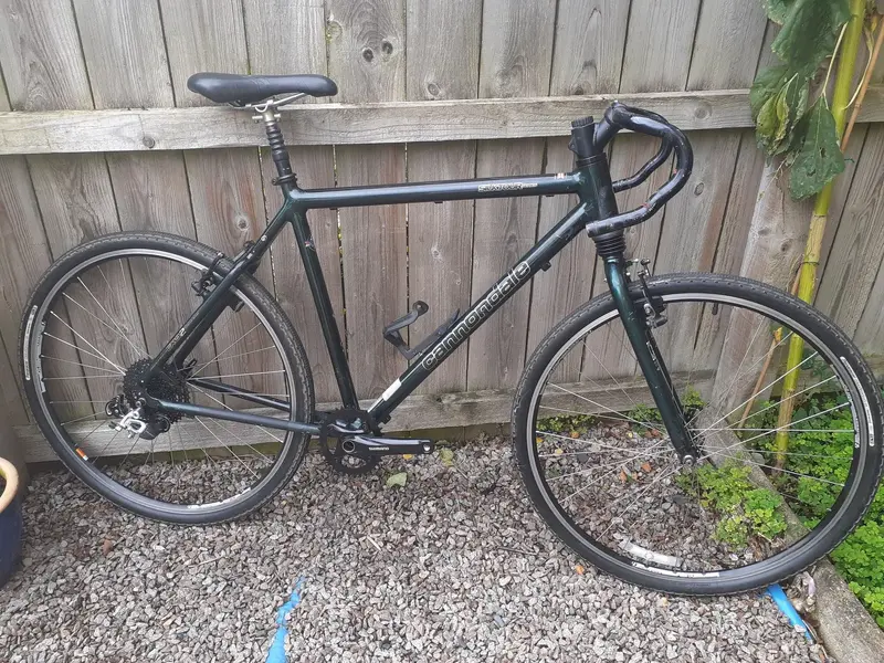

Progress.... 9-speed 11-40 cassette arrived, and chainset with oval 38T chainring fitted. Need to order a new chain as the couple of ones I have are too short.
I was able to sell the original wheels and buy some used ones on Bontrager rims, along with some 38c Panaracer Gravelking SK tyres.
V-brakes fitted, a mix of Shimano/Avid.
All I'm really waiting for is the 9-speed brifters to arrive from the East, Sensah Ignite, should be here shortly.
38c tyres actually seem pretty chunky, so I think they'll be fine, not much room for anything bigger anyway!
When the brifters turn up I'll swap the bars from my other 'Dale onto this, as the ergo bars fitted have a bit too much drop for this build I think.

It's looking good. I always liked the look of the Moulton inspired front suspension on the Cannondales.
