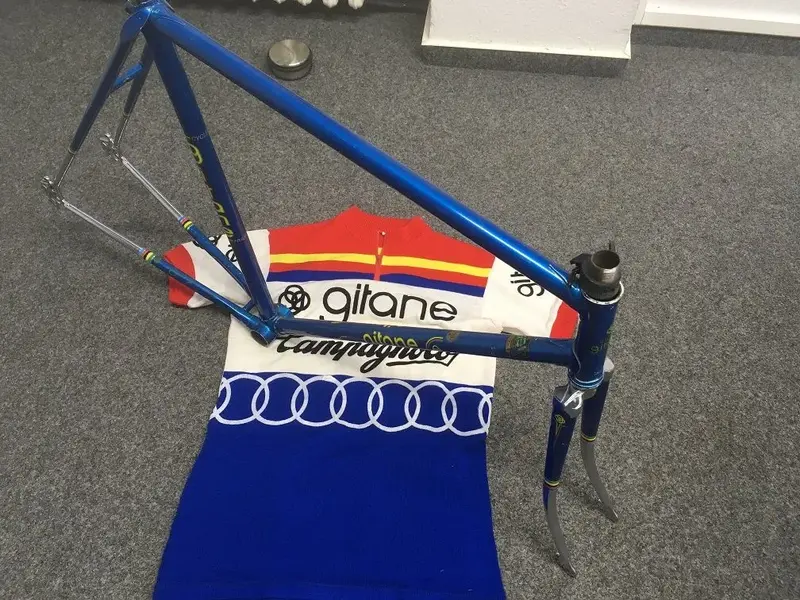

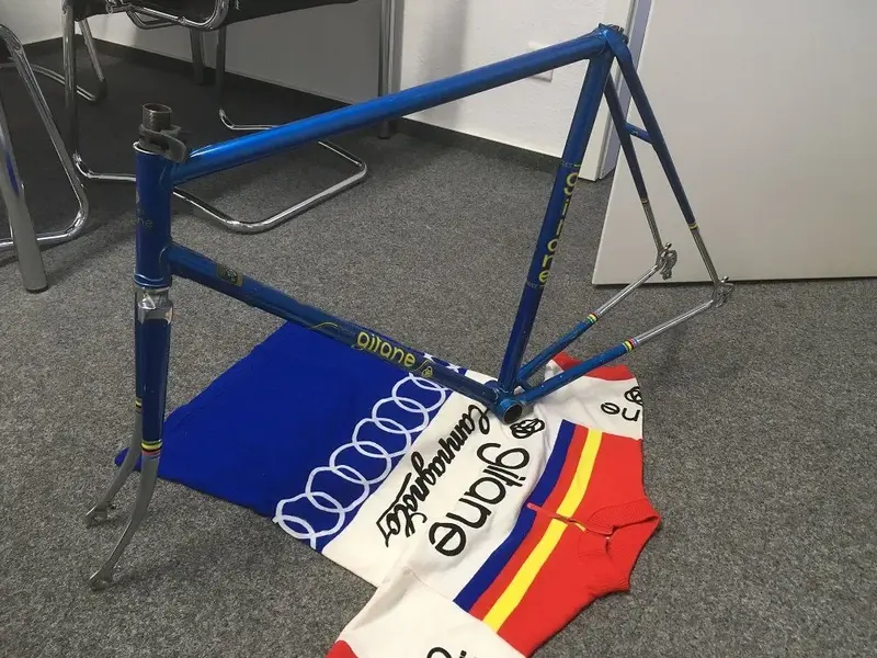

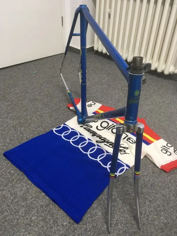

I intent to build up this beautiful Gitane Super Olympic of 1974/75, which saw (with great truth) the light of day in the "Ateliér de B. Carré"
with the 1st Gen of Campagnolo's SUPER RECORD
.. but my question - Which rims will be the correct ones. I cannot find a timeline of MAVIC rims but I think in this period the MAVIC SSC in grey or silver ( soory but - I don't know which are the first) are the first choise of the Pro-rider. A further possibility are the MAVIC Argent rims

There is a pretty good time line at Velobase. Search for velobase "MAVIC RIMS". Although there are still many, many to choose from...
Oh yes thanks there's a lot - but the info about exact using period isn't really usefull within velobase .In the meantime I found at www. velo-retro.com good info about MAVIC rims timelimeesp. the High-End SSC versions ...
http://www.velo-retro.com/mtline.html
here a take out of the period from introduction of Bleu SSC in 1972 upto comercializing Argent 12 SSC in 1977

I'm wondering if half chrome forks and stays would have been evident on '75/'76 season team bikes? I suspect not. The only bikes with half chrome forks and stays in the '75'76 peloton that I can think of are Peugeots. It'd be a shame to lose the chrome now though. Presumably it's been on there for forty five years..
yes - you are right - The teambike of Groupe Sportif Gitane 1975/76 had a frameset made of full Reynolds 531 with Campagnolo fallouts.
By the way Team frame sets ate always with Campagnolo fallouts - never they used Huret version. And the Probike never had chrome on
the front and the rear for saving weight
