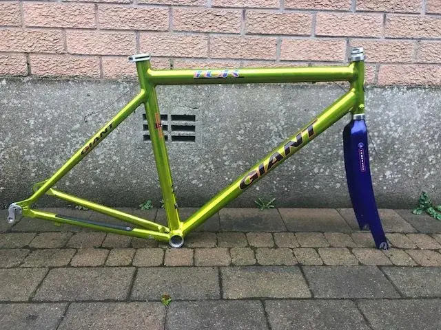

So here's my first pictures
Bike has stripped down and frame cleaned. headset also has been serviced.

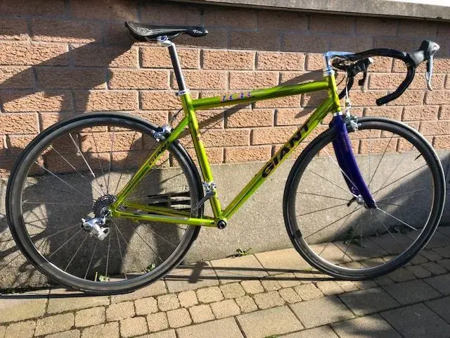

So after a day spent cleaning and fixing ive got this far.
Wheels are Rigida DP18 (non carbon spoke version)
Groupset to be Ultegra 6500.

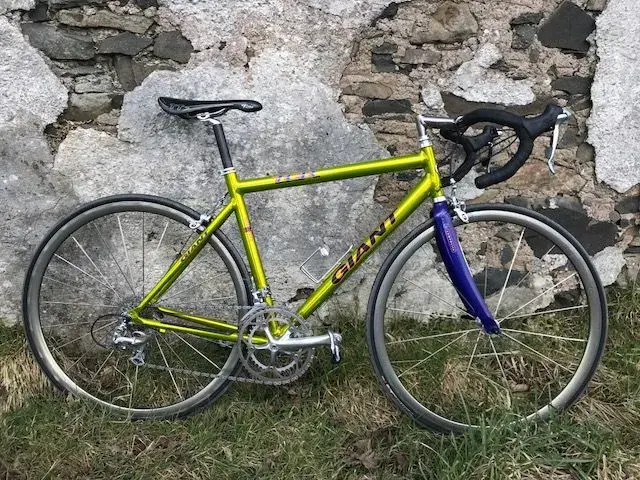

So another bit of work done today.
Bars and stem on, went with a NOS 3T bar I had and a NOS 3T Status stem.
The original adjustable stems where heavy and apparently flexed.
Also installed a non branded carbon seatpost as the Mike Burrows wont is just to big for me.
Also it very hard to get a good set Ultegra shifters so gone with a set of good R600 shifters.

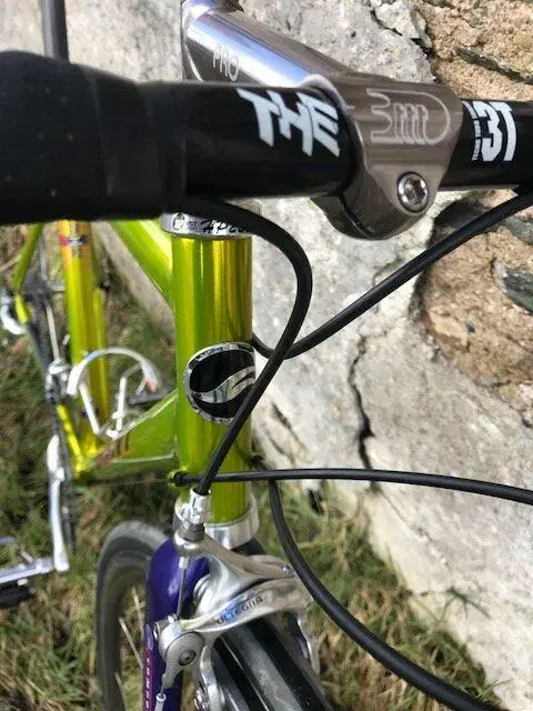

Update,
Chainset, chain and cabling now done.
Just waiting on a different stem arriving so wont put the bar tape on unit that arrives.
but at lease shes now rideable

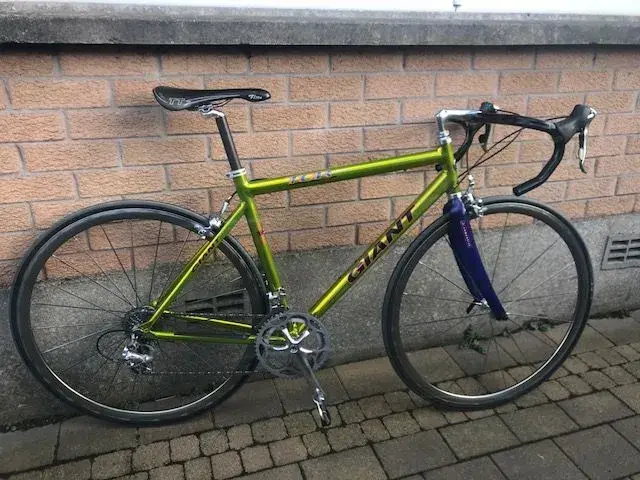

And here's the finished build.
