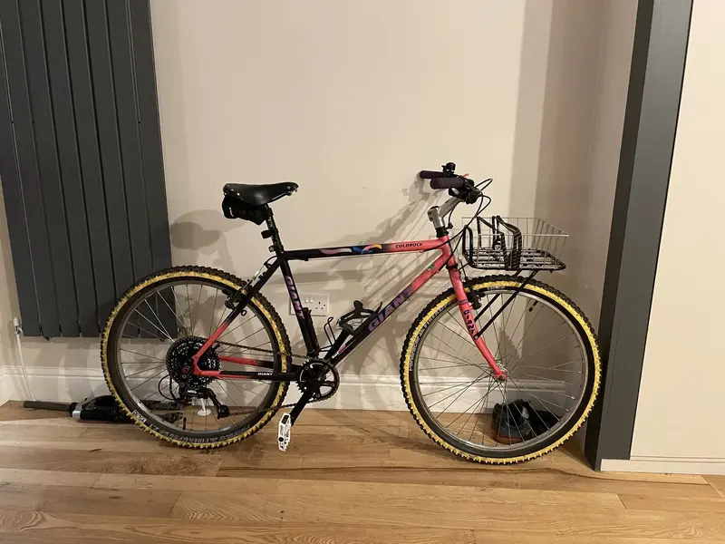

Been riding around on old 26” mountain bikes for a while now and have had the odd lurk on here for info, but have only recently really gotten into them. I have a 1991~ Giant Coldrock that I built up as a commuter. It’s wide range 1x8. I bought a 2000 specialized hard rock and stole most of the bits off it. Lots of cool shenanigans going on there. I’ve used it loads and it’s a really nice bike to ride.

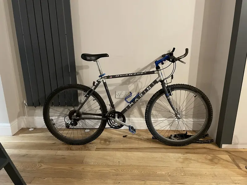

Then I realised I was riding it more than my proper bike, a modern cube gravel thing. So I’ve decided to sell that and I’m going to build this 1993 Marin Muirwoods up into a gravelly touring bike. The frame is a bit nicer than the Giant and I think it would take a bit better to this. I’ll likely do another 1x something. Going to look for some nicer wheels and cranks but despite my original thoughts I might keep the blue bars and handlebar stem because they are so Marin. Not sure how deep I’m gonna dive into this one but I may as well use this to track progress.

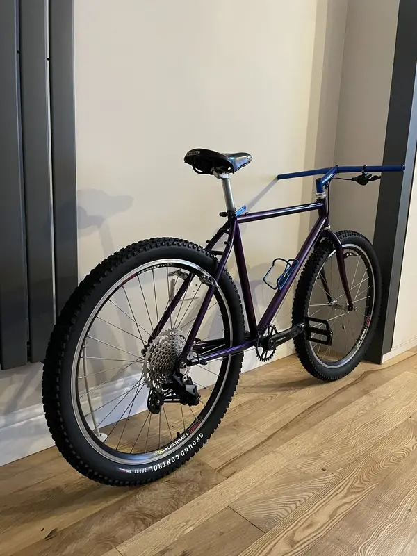

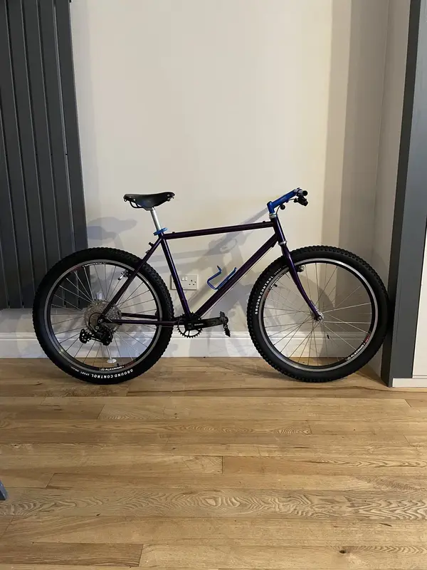

Managed to do some bits to the Marin. Decided when cleaning the frame that it really needed re-stickered, and if it needed that then it was getting powder coated. So I got that done and collected some bits. Most of the bits I got obscenely cheap on Wiggle besides the wheels.

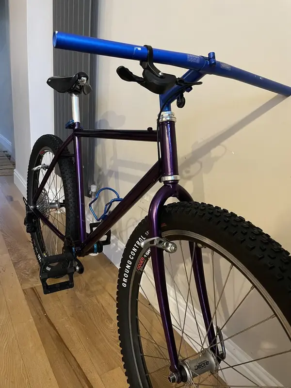

So it’s 1x10 Deore. 11-46. With a nukeproof bottom bracket (that matches the Marin blue anodising!) and sram dub 32t cranks. All pretty lightweight stuff. I also got a tange seiki sealed bearing headset. Brakes are the polished up standard Shimano jobs. Wheels are deore hubs laced to alexrims G3000. These are really light actually - the 2.35 tyres JUST fit and no more.
I’m keeping the Marin lite seat post, stem and bars. I think they kinda suit the bike and it’s nice to keep some original parts. I’ve taken the brooks B17S from the Giant as I have a funky charge spoon for that. I don’t have scales so can’t weigh it but for a steely it’s light.
So now I’m gonna try and find some nice period brake levers, and get a sticker set for a 1993 Muirwoods if possible. Then it’s finish cables and chain.
