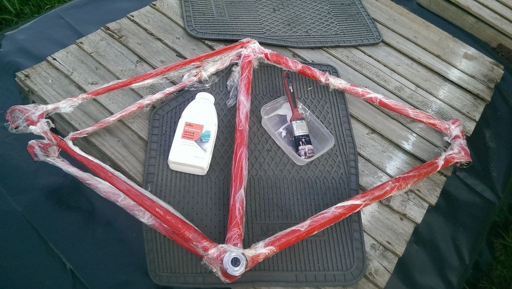

I am stripping an old 1960's Ernie Clements frame at the moment. I've applied the stripper this evening with a paint brush and wrapped it up with cling film. Hopefully in the morning I can apply another coat of stripper and then gently wire-wool the paint off.
I'll see if the theory works and post a few pics up tomorrow ;-)
In my experience with wilkos stripper the first coat softens the paint, the second makes it blister and come off in strips.
I never clingfilmed it, I just completely plastered it all over and left it 6-12 hours a go
