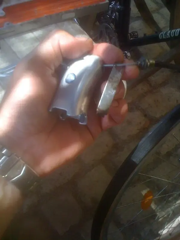

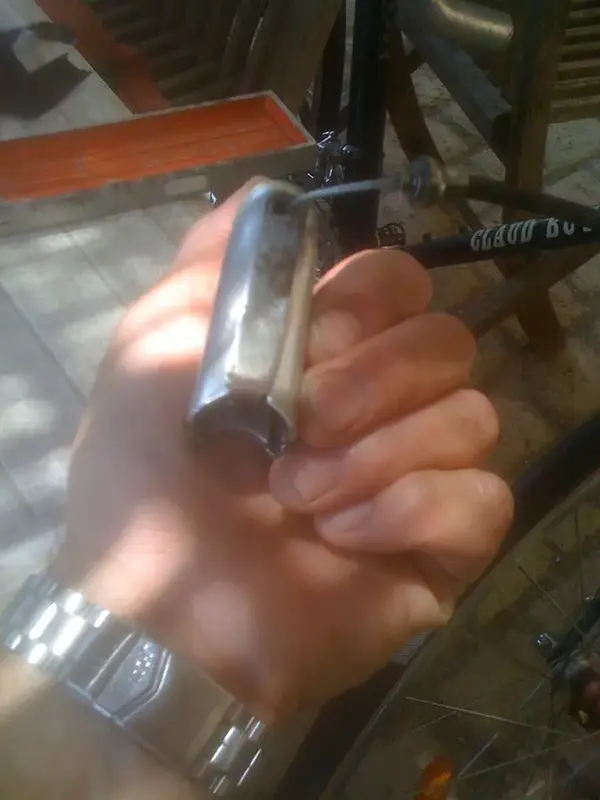

anyone seen this strip of metal attached to the brake lever assembly before? i assume it's there to keep the brake cable from rubbing against the metal housing of the brake lever assembly but ... wouldn't a slightly longer piece of metal tubing in the gromet at the end of the rubber cable covering do just as well?

i'm pretty sure it's simply a low-tech method of keeping the grommet at the end of the brake cable in the hole in the brake lever housing attached to the handlebar. a grommet with a longer piece of tubing would have done as well, me thinks.
that's not to say there wasn't something similar on half-hoods - added support, perhaps.
most memories are dim these days but i have a dim recollection of these being fitted to the brake lever assemblies on the "gitane" i bought, lo' those many years ago ('74 or '75).
I agree with Spokesmann - Mafac used that as a method for retaining their half-hoods, that's how they were attached on my Mafac levers.
Mark.
If it work well without them, leave them off, they are not going exactly feel good in the hands though especially for a rider like me who is always on the hoods.
