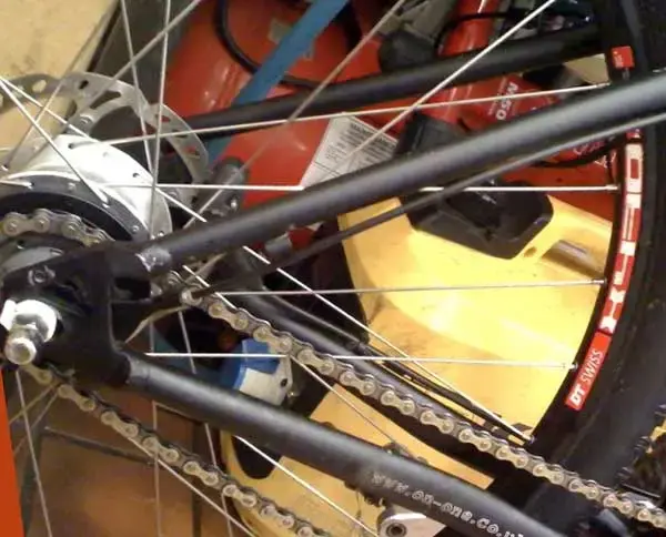

dbmtb":1dm3olav said:
It's because they made it Alfine compatible and Alfine runs a closed cable system. Neither can you run Alfine cable down the seatstays due to cassette joint.
Actually, it can be (and frequently is) run down the seat stay :wink:
You just need to use anti-rotation washers to suit this positioning.
Again, I have never had a problem with under the BB route for a cable on a mountain bike. With the top tube however, if the guides go underneath it, shouldering the bike is horrible and I did once 'catch myself a nasty one' on a guide fitted to the side of the top tube.
Totally agree with you with regards the barrel adjuster. Plonkers.
There's always one.....
Yes - this is indeed true. But to get this far, you have have pretty in depth knowledge of Nexus/Alfine and a willingness to ignore Shimano specifications.
Frequently? I would say the unliklihood of fitting Alfine onto a bike that would need this routing makes "on occasion" perhaps more fitting than "frequently".
I've had hundreds (like as not over a thousand TBH) of Alfine/Nexus bikes pass through my spanners and never seen this configuration before.
I would also maintain that this routing "is a bit dodgy" as fragile cassette joint is a bit too close to the chain and not snugly hidden away under a protective chainstay.
I would however be interested in experimenting with this one day, to see if it would eliminate the frozen cable bugbear. Logically - moisture would run down and out of the system, which is not what happens with standard fitting.
