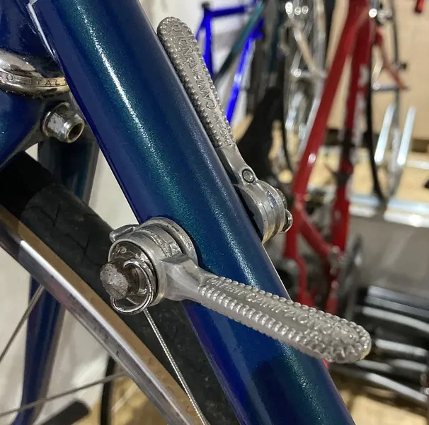

I have a related Stronglight triple issue with a FD. In my case a Campagnolo Record FD works fine in terms of having enough travel, and it doesn't foul the crank-arm (I'm using a Stronglight asymmetric BB axle designed for a triple) - BUT for it to shift over onto the big ring, the shifter has to go ALL the way back so that it's parallel with the ground. Obviously this is not really ideal, but for the right about of cable to be pulled, this is the only way it will do it.
I'm guessing a Suntour Cyclone or similar would solve this, but it wouldn't really look the part on a 60s bike, so it sounds like a Simplex is the only option? And as mentioned, those are rather silly money...

Another not-too-intrusive option is to slip a bit of outer cable liner (or similar) over the shifter cable where it runs over the shifter barrel. This will effectively increase the barrel's diameter a bit, resulting in more cable pull.
It might give you just the extra bit of pull you need.
