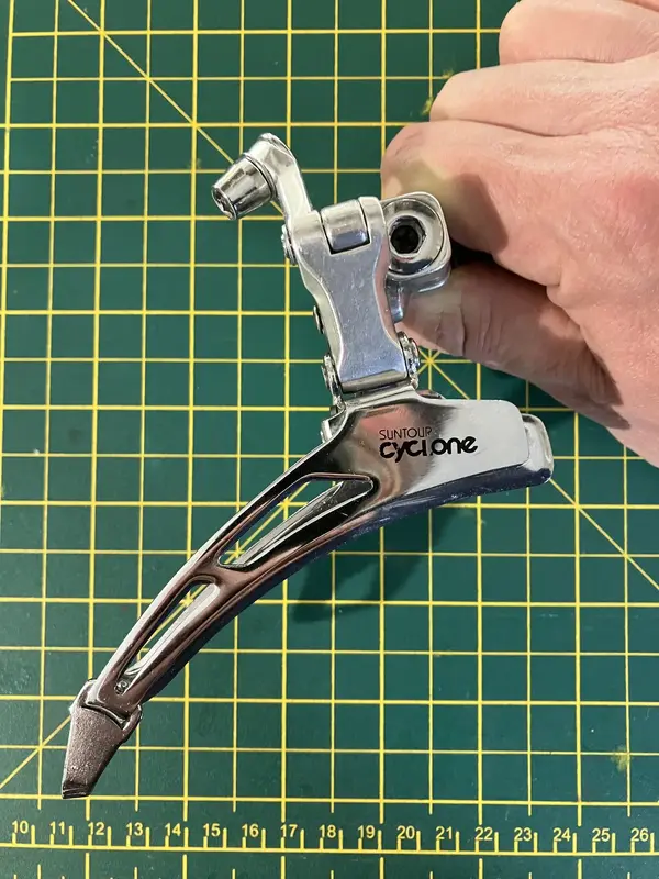

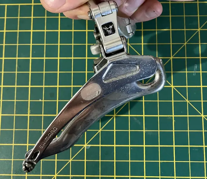

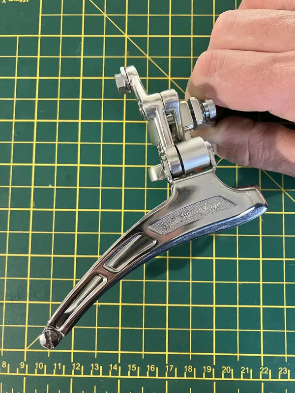

Okay, for completeness, here’s the drop results for a few 80s mechs with flat cages that might be easier to source. Measurement is for the inner cage when the top of that is level (approximates the seat tube angle, although note that actual ST angle effects your drop). Measurement is not from the photos, they are hard to calibrate and just for reference.
Suntour cyclone 1 = 54mm
Suntour Cyclone 2 standard = 65mm
Suntour Cyclone 2 with extender = 75mm
Shimano Deerhead = 76mm

Suprised the 1st gen Cyclone is so much smaller in drop, guess the others were influenced by or were for Mountain Bikes and lower triples than were run before.
The 1st gen cyclone would be the best fit aestheticly on a mid- late 70s/ early 80s Bridgestone I guess. Certainly would look good with a Shimano 600 Arabesque rear (long cage, which will hopefully help things). I'm kinda liking the idea of having a bit of a Frankenstein Groupset... in the past I've usually been much keener to keep it within the same line.
Current plan is to run either 48/38/28 or 46/36/26. I'm guessing I need to think about Aesthetics vs performance, but hoping a Suntour Cyclone could cover the above range.
Yes, looking at the cyclones side by side the Mk 1 has a flatter curve if that makes sense. My workaround is to pinch the extender from the cyclone 2 and put it on the 1 - but it’s taken a while to find.
