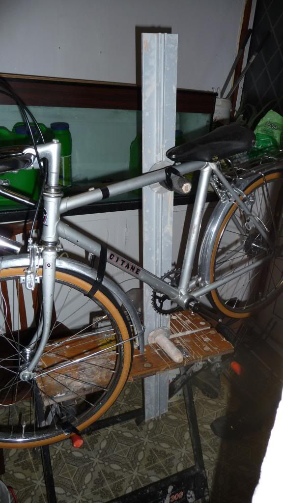

Hi Richard I couldn't remember how to set the chain length against the smaller cassette cog or larger one I think its smaller.
I still have the original chain but its 34 years old so wanted to reset the whole gearing system from scratch?
Plan is mount the derailleur wrap chain around the smallest gear cog and split the chain to right length as for adjusting the Huret Derailler I was going to fit the gear cable. From that point onwards trial & error to see what each screw did LOL!
Not sure how taught the gear cable should be either? Its a three gear one lever system by the way

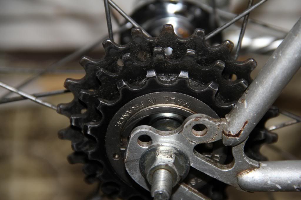

Ah ok, well what i do, and perhaps someone will confirm, is large chainwheel (front) to largest cog on the freewheel (rear) - a gear you should never use as it can damage the chain. Run the chain and tighten it until the rear mech is almost vertical and mark the chain. Split it and remove excess links, rejoin and should be job done. If anything i leave it slightly longer and i can remove another link if required.

So set it to largest cog first like the picture bellow?
Yup You are trying to achieve the longest distance the chain travels - largest cog in pic above to largest chainring at front.

I would take some more advice - with three cogs it probably makes very little difference which one you use to set it up.

Okay that makes sense don't know why I thought smallest first I remember when I was a kid someone said the derailleur will extend the chain for distance length? I was a kid of 9 :lol:
