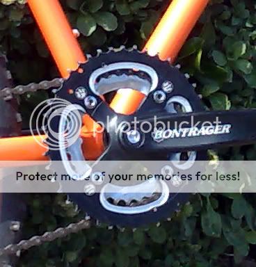

I need to convert the big ring on the Voodoo into a bash ring..
I have some cutting wheels for the Dremel and some sanding wheels too..
Is it a fairly low-risk (in terms of effing it up) venture?
Simply a case of cutting off the pointy bits and sanding of any remaining lumpage?

It'll be quicker (and cheaper) using a file than faffing around with a Dremel.

In my opinion converted chainrings always look crap as bashrings as they're far bigger than you need.

The chainring is a Bontrager one and matches the crank arms.. and it's the Wifes bike and she likes the little paw prints on it . . :roll:
the new ring is a 36t and black so a little bigger (that silver middle one is a 32T)
If you have a mate who has access to a lathe, then the easiest thing would be to chuck it in a 4-jaw and get rid of the teeth that way - if you only want it for chain retention (and not for chainring protection) you could afford to lose quite a bit on the OD and take it down to the outer shifting pin holes for example.
You could do it by hand too, of course, it'll just take longer and won't be as easy to get a good finish - a pity that you're not just down the road, I'd gladly do it for you.
Sadly no lathe-owning buddies near me.. wouldn't even know where to start looking for local engineers either..
It is only to help with chain retention and aesthetic appeal, it'll never have a hard life even if I take it out for a spin.

Well.. now I know I'm on the right lines with the chainring, I'll just have to take my time and do me best ;)
i did it quite easily the other day
i say easy, it took me a few hours as i was using a drill rubber disc thing which the sandpaper screws onto, it kept chewing up the sandpaper but i got there in the end

If you fancy a trip to jct 14 of the M25, I can do this for you in about half an hour. Here's my 42T Truvativ ring that's now a bashguard:-
