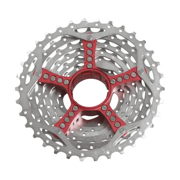

The aluminium spider on the SRAM cassette is a narrower fit and may need a slim spacer before you place it on the hub

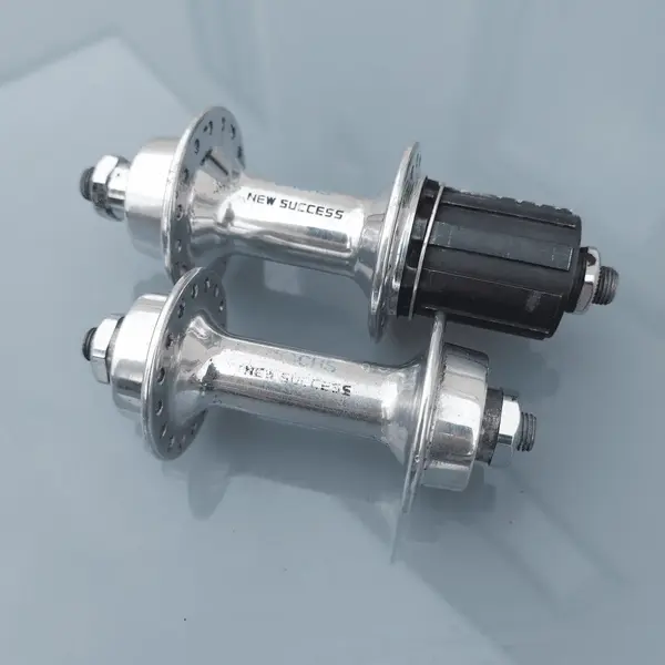

heres some Sachs hubs with the spacer
and without
Heres a 990 cassette and theres a little recess in the aluminium cage that can end up hitting the hub lip

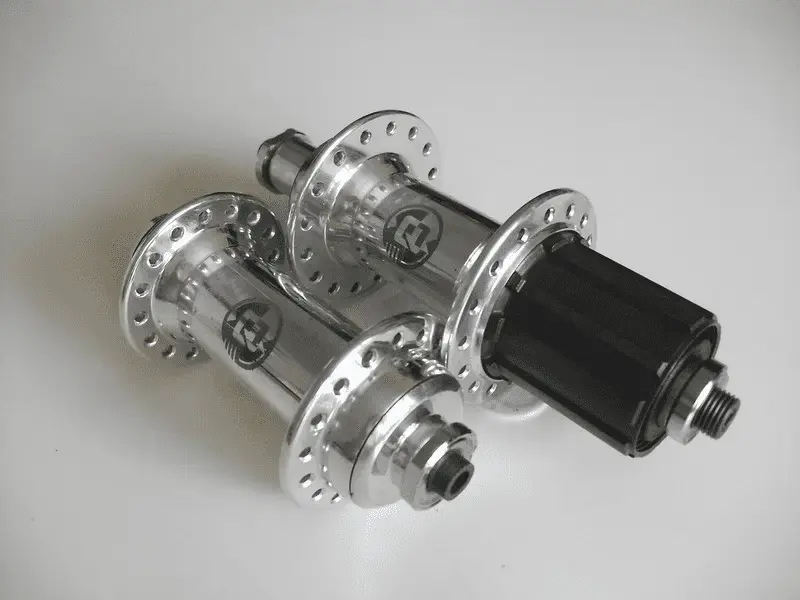

and without
