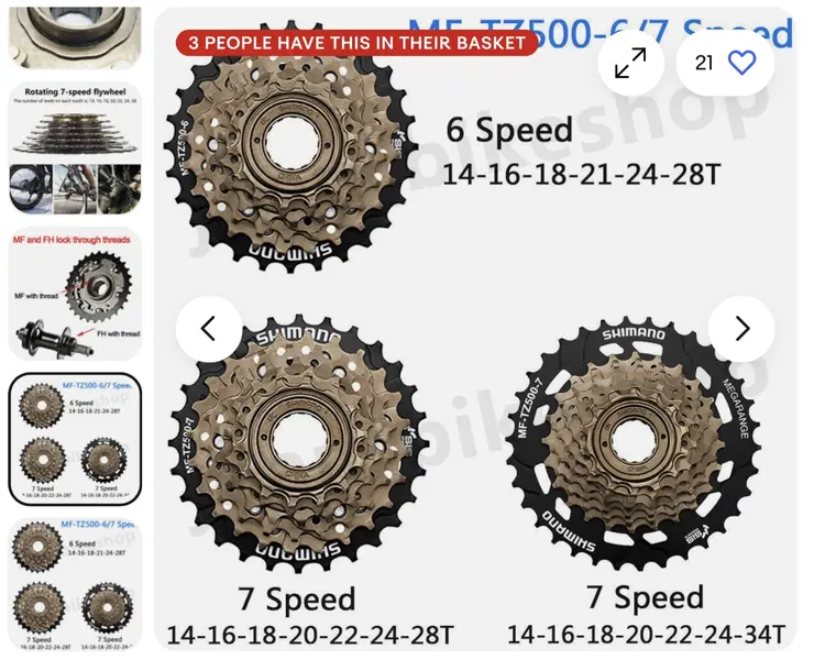

Shimano Mf-tz30 6 speed tourney did 14-34,
although if you're not using one of the tourney Megarange dérailleurs
(and you wouldn't really want to)
you might need to choose your r.mech carefully - some can be adjusted to handle 34, some can't.
If its all shimano, the indexing should be spot on.
Yes, the changeability of Suntour cogs (and Malliard) is what I’m after but with those lovely hyperglide ramps. Mega range is an option but the 6 speed ones seem to jump from 23 to 34.

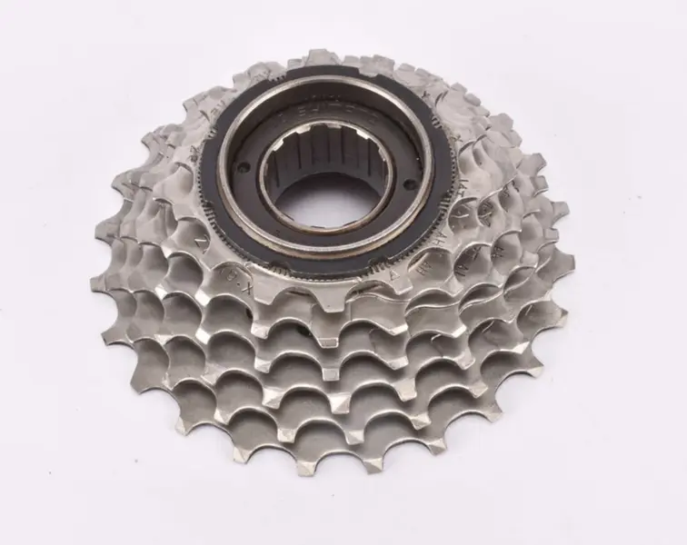

Is there a way to crack these? ⬇️ Looks like the small one might screw and then the first few slot on with the last three on a carrier? Could then mix and match 7 speed cogs onto 6 speed wheel body perhaps.
…. Edit, but if you can’t crack the carrier, then you’re stuck with the big final step…..

Just for info, in case anyone else falls down this rabbit hole, shimano did do a traditional (no carrier) freewheel with hyperglide cogs, Tourney MF-HG22, but you’d be hard pressed to find any uphill ratios for it:

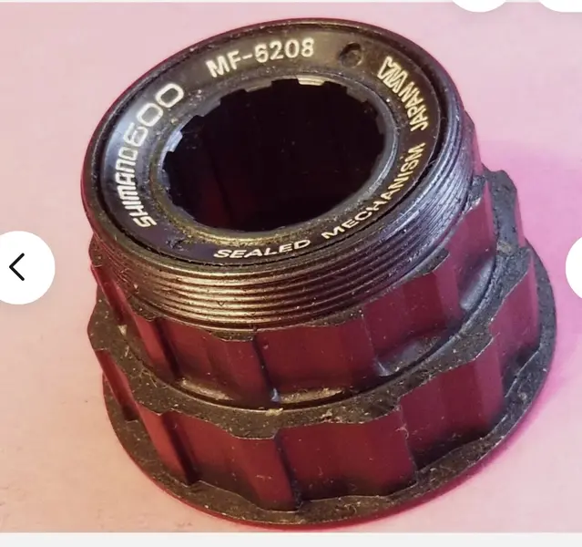

Here’s a bare 600 freewheel body showing how the cogs slot on:
