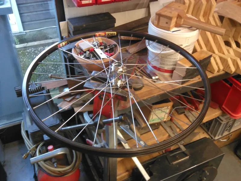

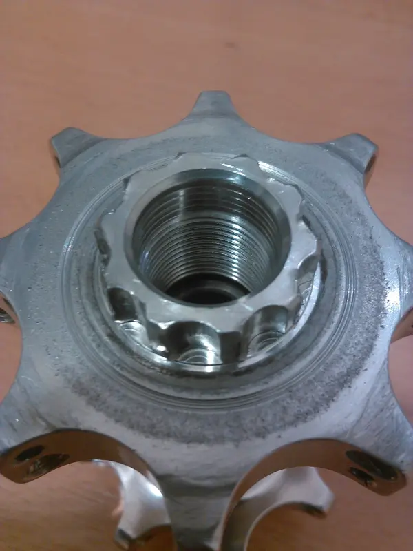

Lacing now complete, minus one missing spoke. In the meantime, I had a look at the whole Park Tool catalogue. Except for the SPA-1/2/6 pin spanners, nothing that would resemble the 4-pin thing I'm after.
Two screw drivers in a trench coat? Sorry, I meant two screw drivers in the bench vice? Or better yet a pair of pin punches. If that seems a bit Rich, two masonry nails woth the tip cut off.

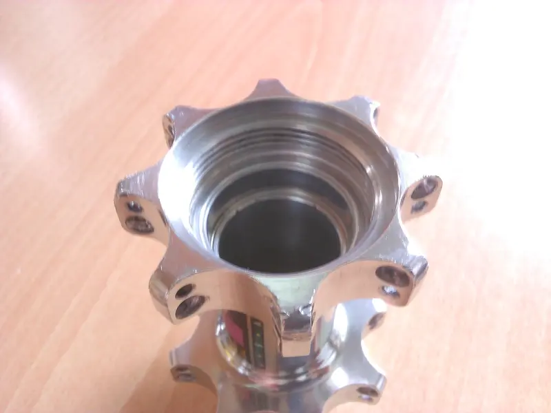

So it would rather be four screw drivers or pin punches ;-) As the problem is not being two (the Park Tool SPA-1 pin spanner can do a better job in this aera), but being four to hold the freehub support strongly enough without damaging the pinholes. But the masonry nails is a nice idea: now that I think of, four masonry nails with the tip cut off in a wooden block and the wooden block held in place in a vice.
The splined freehub boss is a permanent part of the cover?
It will be a lot easier to get adequate grip on this. I suspect the alloy of the pin holes will not take the force required to get it moving.

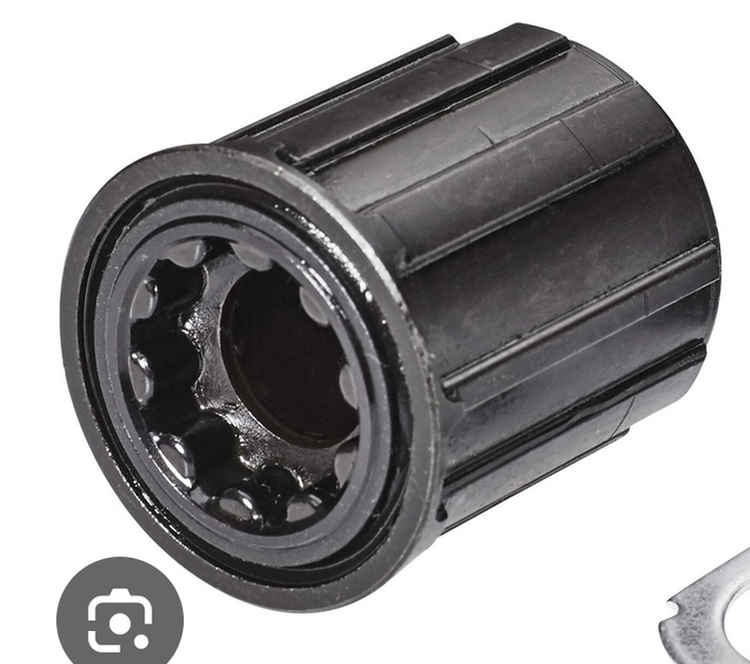

The freehub boss looks a lot like the shimano one -
Screenshot_20241005-203349_Firefox.webp if that's so, you could destroy a shimano fhb to get the socket out... then either grind flats and grip in a vice, or weld a lever arm on to it.

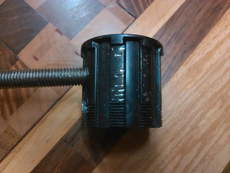

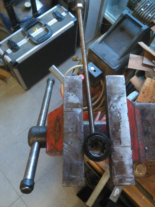

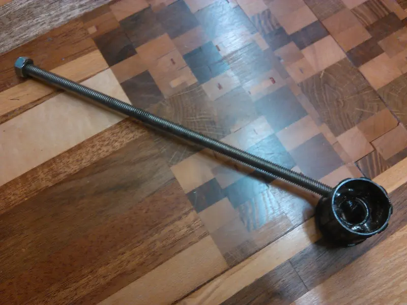

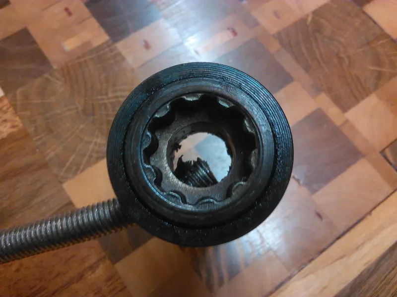

There you go. A dead freehub body was drilled to insert and weld in place a rod blocking the socket (initially, the rod was perfectly straight; more on this later). Yeah, I didn't have sufficient time to properly disassemble the freehub body (don't know how/what to do, BTW) so just brute force here. My Dad isn't a professional welder either, so even go through the freehub body while welding!
I'm worried your bar might be a little feeble for the job, but you could use a large self- locking wrench on it now.
We have a humongous one at the shop. It can bend Anything!

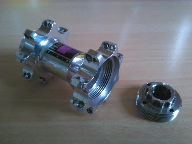

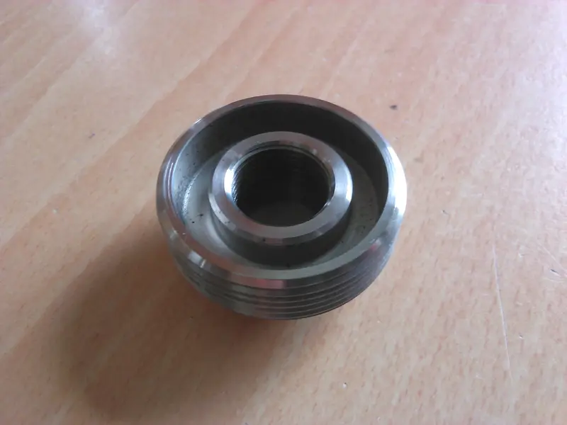

Even with the help of a heatgun, it required a considerable amount of torque (two people) to unlock the freehub support, hence the bending of the rod! But in the end, tadaaaaa!
