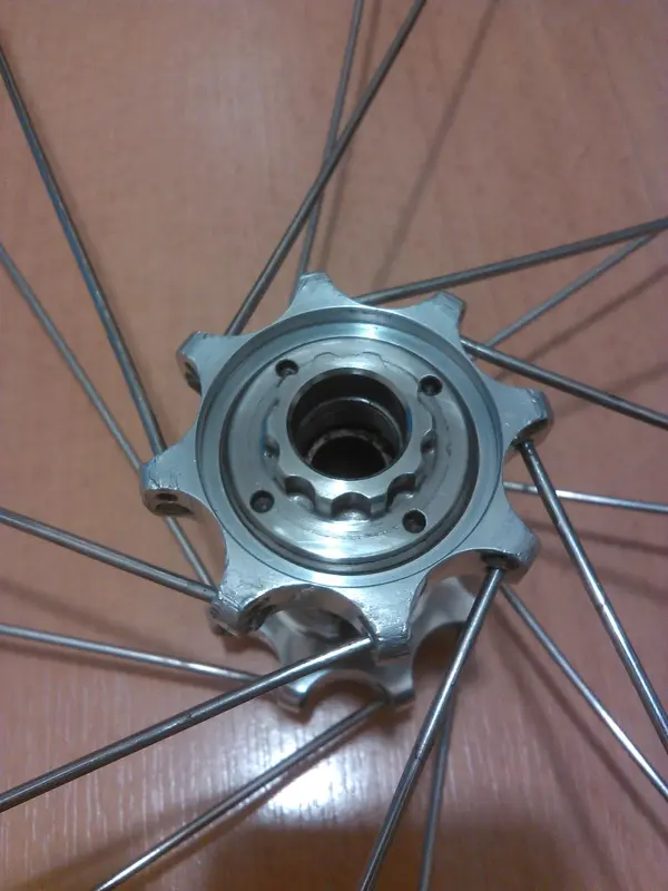

I'm working on a rear Pulstar hub. USA-made, not Taiwan. The drive-side bearing is shot. But to extract this (sealed) bearing, I had to remove the freehub, including the star part (don't know the name) that screws into the hub shell. This star part has 4 pins, 2.2mm diameter each with 26mm diameter between them. Should I go with a pin spanner ala Park Tool SPA-2 (or SPA-6 for an adjustable one) or rather something like the HCW-4? Or any tool that would plug in the star directly?

The shape of Park Tool HCW-4 didn't allow reaching the pins of the freewheel support. So I went with SPA-2 pin spanner. Now THE question: unscrew in clockwise or counter-clockwise? I tried counter-clockwise, as freewheel will naturally screw clockwise when pedaling. No progress at the moment... Or maybe the freewheel support is furthermore bonded!

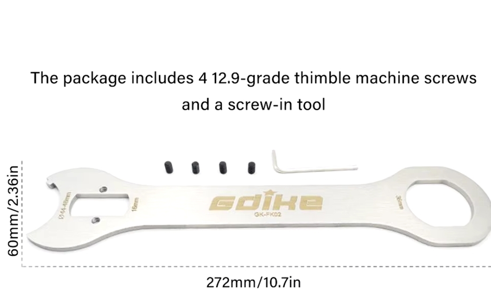

Id suggest making a 4-pin tool using something like this with those replaceable pins: Screenshot_20241004-203437_Firefox.jpg

Can I just point out that it looks like the hub is only half laced, I would usually, like others recommend using a vice and turning the wheel, but in this case with a half laced wheel you could twist the rim
Only one way though.
But if the freehub drive force is transmitted to the hub through the plate, its going to be a right hand thread to remove, and stuck on there big time.
