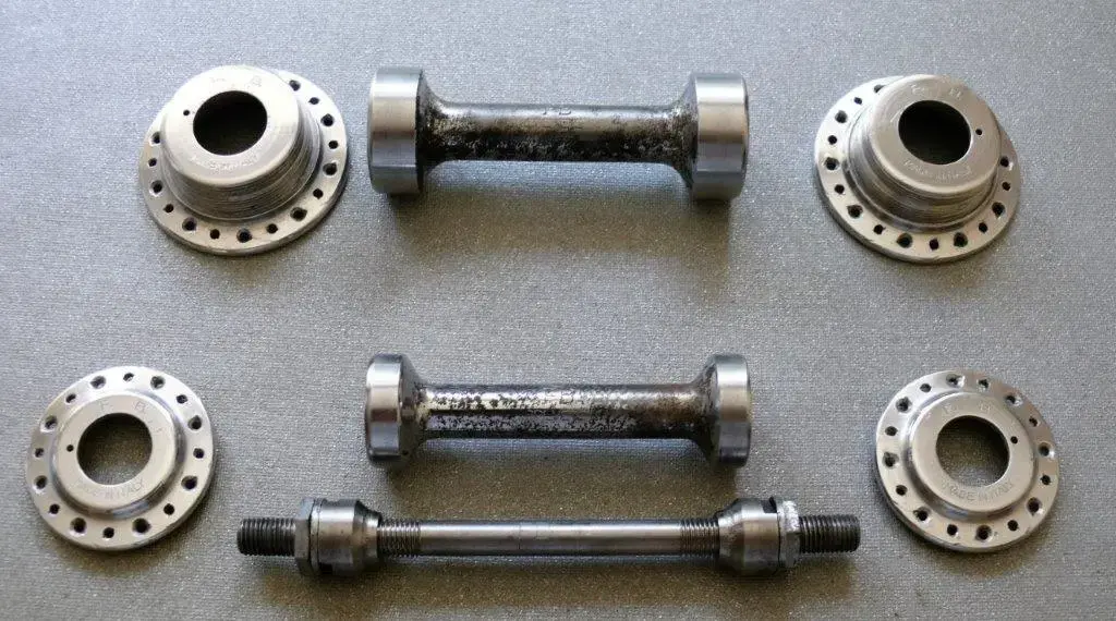

By way of an update :
I have been able to get the flanges removed from both F B hubs (along with an early Campagnolo and an early Gnutti) with little difficulty courtesy of Mick Madgett. I will have the barrels re chromed (retaining as much of the engraving as possible and without machining the flanges) and then with luck I will be able to get them re assembled (bearing in mind the spoke holes must be offset)
See picture of hubs in pieces.
I will post again to confirm the end result which (hopefully) will be a success

By way of an update concerning re plating of hub barrels, I have recently acquired a number of hubs with steel barrels / alloy flanges to attempt re-plating of the barrels. Campagnolo Gran Sport - low and high flange, Fratelli Brivio - again both LF & HF (identical to Campagnolo since they made the Campy ones !), Gnutti LF, BH Airlites HF, Bayliss Continentals. All have been successfully taken apart in order to get the barrels plated. I have asked the plater to attempt to retain as much of the original barrel engraving as possible. On the BH and Bayliss barrels I suspect it will be lost (even new ones c an be very faint) on the others it should be OK. The real test comes when we need to re-assemble. Will the flanges still have the correct tolerance ? Will we be able to align the spoke holes offset correctly ? It will be interesting to see. I will post again when I have some finished, but am already of the opinion that just about any hub requiring this can be salvaged.

Splitting the flanges from the barrels is quite easy - simple case of reversing the process that put them together. Heat the flange with a blow lamp then drift the flange off with a hammer (rawhide type is best - you do not want to damage the alloy). Aluminium has a far higher expansion coefficient than steel so it loosens readily. Reverse requires heating the flange and drifting it back on . Hard part is alignment as the spoke holes must offset exactly 50%. I would add that I do not do this. Mick Madgett (Madgett's / Diss) has made a jig for this very purpose and has kindly done a few for me (including FB) at a reasonable cost. Local metal finisher will handle the plating (must not reduce the flange dia. after stripping existing chrome though. As previous - when I have some done I will post some before and after photos.
Further update. I have now had a range of hubs separated ready for the barrels to be plated. These include : BH low and high flange Airlites, Bayliss Wiley Continentals, Gnutti, Campagnolo Gran Sport and F B. After removal, there is clear evidence on some that something was put on the flange before being pressed in (along the lines of Loctite ?). Mick Madgett recommends using a smear of something like this when re-assembling them. More to to follow if ever the metal finishers get my plating done !
