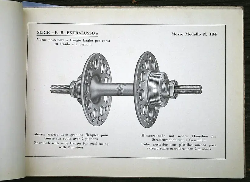

I did read somewhere that Brivio had a manufacturing facility in France - or maybe had contracted someone in France to make them. I have also heard that these hubs have been seen branded Legnano and Simplex - but cannot confirm this as I have not seen them 'in the flesh' so to speak. I have seen no advertising pre WW2 that suggests that large flange hubs were around at that time, but.....you can never be certain. I think that the attached images are from a really high quality catalogue from ca. 1951. Would love a copy of this !!
