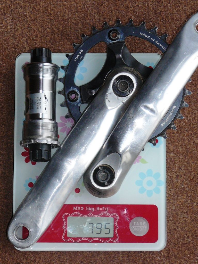

Got the crankset complete now with 32T Blackspire SS ring and an ES71 73mm octalink BB.
Under 800g for this lot , not bad :)
So total so far now at 3461g = 7.62lbs

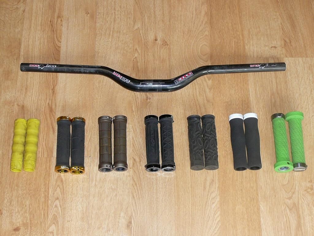

But for now my bars have landed .... RaceFace Next XC OS risers 660m wide = 176g and I have too many sets of grips.
So now being a bit of a WW nerd I have weighed them all as follows from left to right,
Onza Ules = 75g
Superstar = 115g
Outland = 100g
RaceFace (lock on) = 94g
RaceFace = 101g
KTM = 99g
DMR = 123g
and the green DMR's I wanted to use are of course the heaviest so now thinking I should get some simple foam ones or just use bar tape. Is there a cure for this condition ?

I've done a couple of similar projects - weight weenie on a shoestring. The last few grams always end up costing the most! M751 cranks are a good choice and the matching ES71 BB is also lightweight. M752 are a tad lighter and have a nicer shape IMHO than the 751. Weight-wise you can get similar results from an M570 with a UN7x BB.
A couple of other recommendations for £/g savings. Grips-wise, these £4/25g foam ones from ebay: http://www.ebay.co.uk/itm/25g-Ultra-Lig ... 1087520199. If you have a standard-ish size seatpost size, these are £17 and ultralight: http://www.cyclomonster.com/cart/gub-li ... -post.html.
