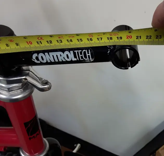

To partly resolve this ive found a long enough, controltech stem with a good rise.... that helps. The stem just needed a new pair of decals, bit of touch up and a coat of new clearcoat......perfect.

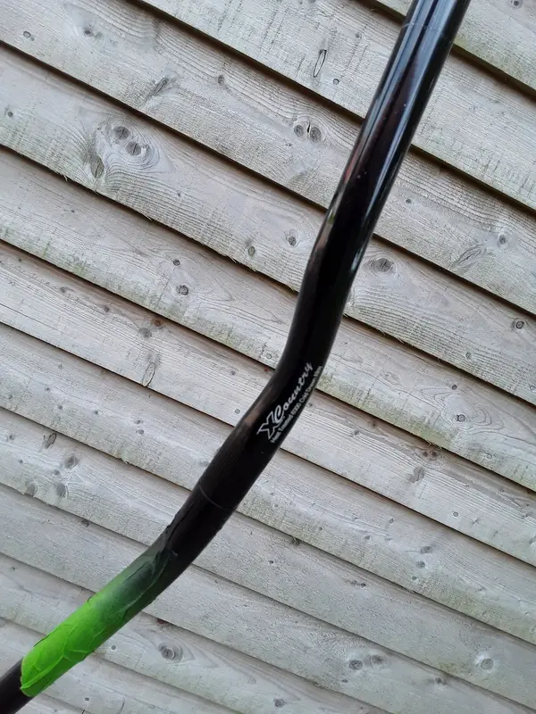

Just some bars........you can all see where this is going can't you.....im sorry.
Test set karma'd to me and then a nice full length pair came my way via retrobikeguy.....who is a diamond. Bit of air brushing, polish out and a coat of clear and they are like new.

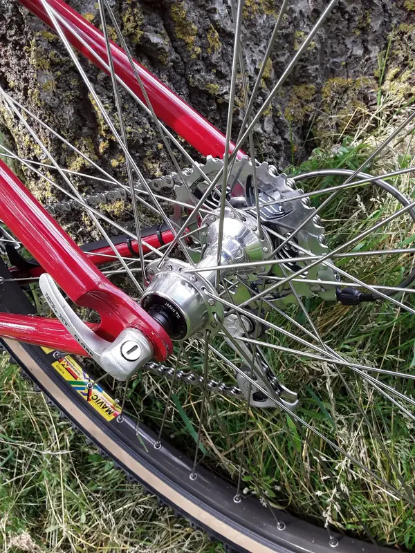

Just when i thought i had got my wheel choice sorted......somebody offers me a set of my favourite mavic m261 on m732 hubs!
Then it turns out its a set i built from nos parts a few years back for his mate!
Quick drive, £50 and an hour cleaning and checking them over they are ready to go.
Plus, on route i poped into micks little shop in diss and found this lonely looking cassette, just asking for a home. Rude not to take it really....

The above has also kinda made me decide what to do about the xtr m900 hubs and brifters im sitting on, as karma clearly wants this to be 7 speed!
I didn't build the xtr wheels as i never found a good set of rims i wanted to use on them and the above wheelsets floated my way.....but....something may come along one day..

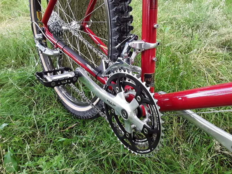

XTR cantis cleaned up ok, with new bbb cantistop pads installed. Normal canti faffing....probably the only good thing about v brakes! Only issue was one needed the internal ferrule fettling a bit as it seemed to bind slightly....but ok now.
XC pro shifters and hopefully brake levers when a pair pop up at pre war prices.....for now its ritchey logic out of the stash along with matching grips.
Pedals came from the stash and the cages were cerakoted in the last batch to come back. New bearing and seals fitted.

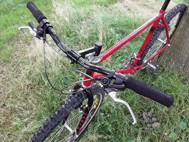

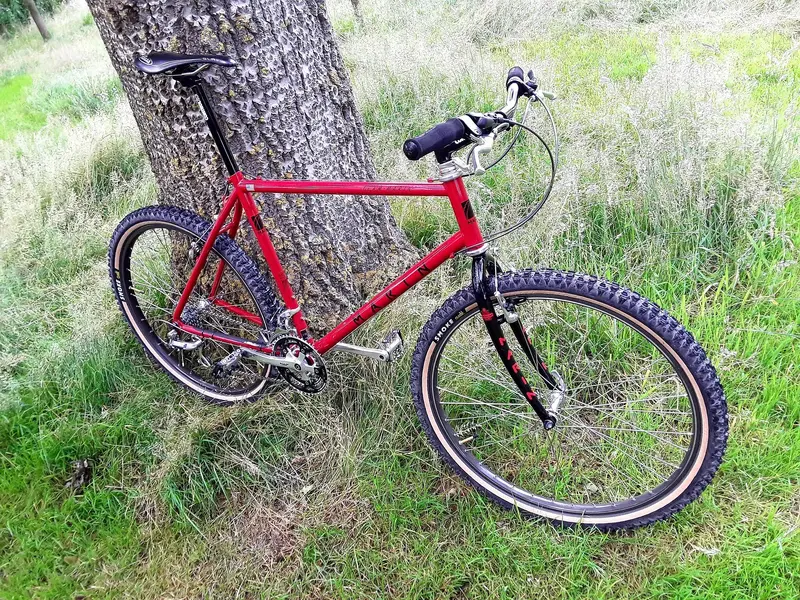

The old seatpost has sprayed up well (inappropriate stickers giving some relief) and im pleased with the finish on the parts given the state that some started in. Still want a "holey" 92 /3 marin qr.....if anybody has one? As youcan see the post is pretty much on the limit in the 19" frame (20.5" c to t)! Eeek.
Tyres....went for panaracer smokes, but honestly might put my old racing ralphs back on from my maxlight for general xc use round here.
Seats a direct swap too....oddly i find the SLR very comfortable even on longer rides, regardless of its lack of padding.
Thanks to everybody who sent me parts for the build.....just need to get out there and see how it goes.
And again I apologise for the riser bar content......but us storks need a higher perch!

Well this looks like a blast to ride!
Come together very nicely. And quickly, too!
I have a black "Holey" Marin QR you're welcome to, if you'd like? A bit dingy, but should clean up OK.
Will just need it during the build for the 92 Team Issue (just for trying things in/on!) But don't plan to include it on the finished thing.
I cant fault that. Tasteful parts load out and the whole machine looks purposeful.
