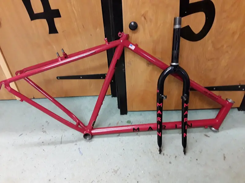

This what turned up.
First off, i want to apologise to anybody of a sensitive nature or anybody with a compulsive syndrome that leads them to do catalogue builds.......in fact if thats you, step away now.
So, after some head scratching and elbow grease all became much clearer......physically and metaphysically.
Physically, the application of t-cut paint restorer and a few coats of wax polish did wonders. The powder coat is so good i thought it was wet painted to start with!
Metaphysically, after talking to a few mates and looking few a few notes all became clear. The frame number makes it a 92 team marin, but marin is frankly tricky due to their rather weird decisions over number practices ( there's another whole thread just there).
However, its got no mounts, like team issue, BUT, down tube stops like a pine mountain.
The colour kinda gave the game away to a degree; somebodys painted 92 team to look like a first edition 91 monostay team issue.
That also explains the missing mounts......ground off.
But those down tube stops and where's the rifled tube? Simple, its not a European territory bike, for some reason other regions got down tube not head tube stops on their teams and it seems were almost a year behind on tubeset changes!
Finally, just as a double check, I weighed it.....its exactly 48 g lighter than my other team marin, which makes sense as its a size down, plus it has the tell tale bulge butted tubes.
What does all this show.....well its very easy to get confused and be careful when buying! Its not aways that simple and with the prices as they are....i would hate to see somebody buy a team only to find its actually a rebadged Eldridge!

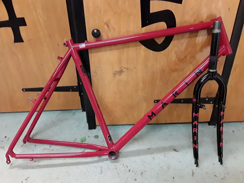

So here it is after a bit of elbow grease.

Looks like I've succesfully unleashed some terrible confusion on the retrobiker society, I'm afraid. Let me set the record straight: so the frame was mine, I've bought it as a bare 1992 Pine Mountain frame - with shabby OEM orange/black paint. I got it powdercoated this lovely cherry red and had the eyelets removed professionally - to make it look a bit fancier. Although it's quite light, I've put the Prestige decal on it only due to the bulged seattube-as they're always present on other Prestige frames.
Funny, because the OEM sticker was a common blue on black Tange double butted lettered one - a factory tubeset (leftover) special, maybe? Anyway, don't bother, it's a rather nice example, as you stated the powdercoat is second to none, so just enjoy it and happy biking to you!

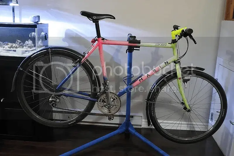

As for the cable stop issue......theres lots of examples of other territories bikes with this arrangement on teams. See below as just one.

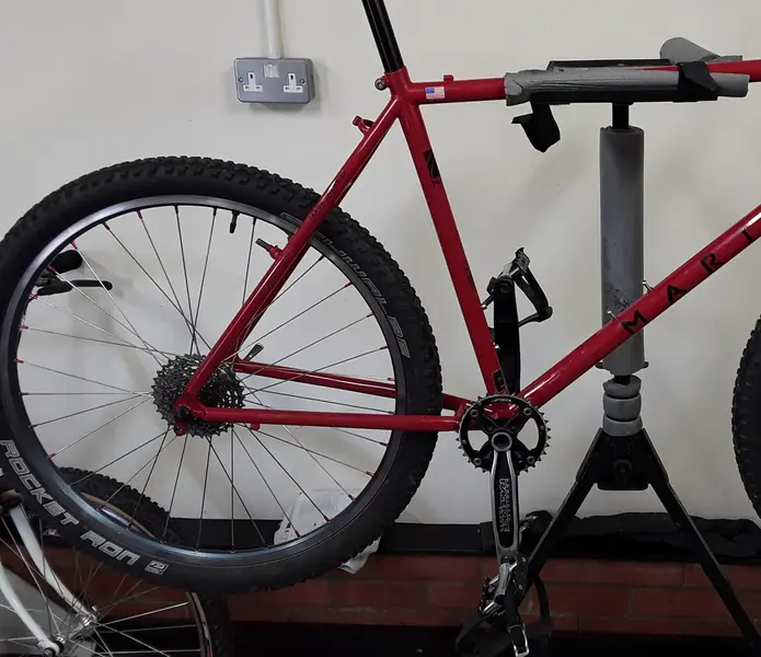

Here's a picture of some wrongness. Even the rims are the wrong colour! Just wrong.
