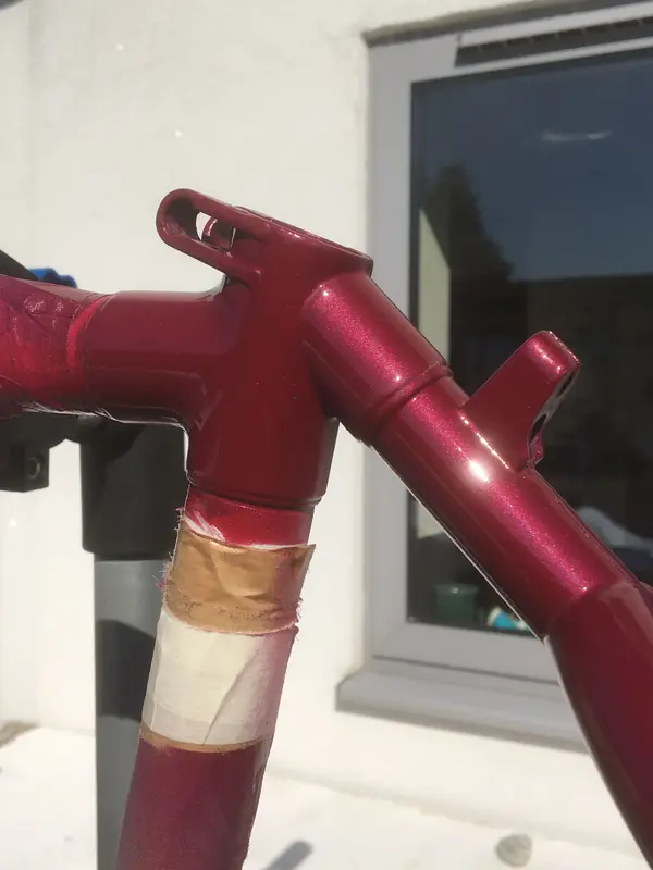

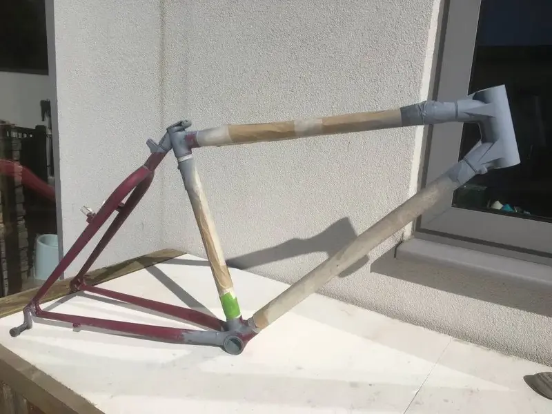

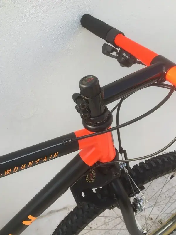

Personally, I don't rush the Lacquer coat either. I allow the colour to harden for a least a week before clear coat. I then gently scuff the painted finish with fine scotchbrite to give a key for the lacquer to adhere to. Then leave it well alone for at least a couple of weeks to harden before attempting a bike build.
With time and patience you can get a great result..... My Marin Pine Mountain (in my signature) was a home paint...... That went on to win a BOTM.
More recently, my Dynatech is also a home paint. There's some pics of the processes in both threads.
