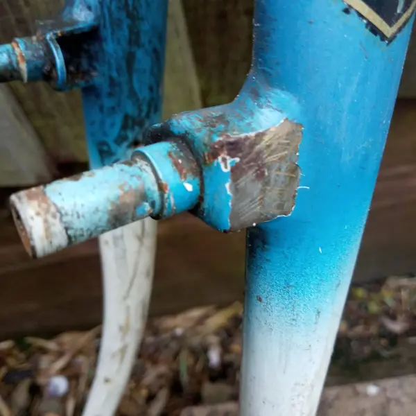

Can you post close up pictures of the fork crown and as I mentioned before scratch some paint away to see if you still have chrome, also look for chrome on the cantilever bosses on the fork.
I've had a gentle scrape at the paint and it definitely looks like there's chrome underneath, possibly all the way down the forks (but doesn't show up very well in the 3rd photo). But no sign of chrome on the cantilever bosses, so I'm guessing that they are later additions. IMG_20230310_133602.jpg IMG_20230310_133616.jpg IMG_20230310_133708.jpg
I've had a gentle scrape at the paint and it definitely looks like there's chrome underneath, possibly all the way down the forks (but doesn't show up very well in the 3rd photo). But no sign of chrome on the cantilever bosses, so I'm guessing that they are later additions. View attachment 719072View attachment 719073View attachment 719074
Good news to find the chrome, the forks would have been full chrome and just removed locally for the braze on, this confirms they're a later addition. The brake, gear cable guides and pump pegs i think are a special order by the Carlton Works as this is offered for the Giro and Contre La Montre frames it would be the same for the Mk1V Professional. The paint will have to be removed with paint stripper and the condition of the chrome assessed, the rear triangle would have been chrome and possibly extra chrome on the frame 👍 Might be worth moving this thread to reader's road bikes.
