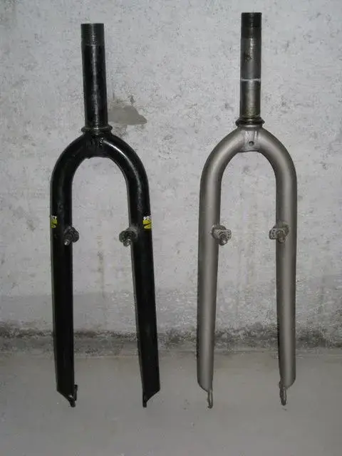

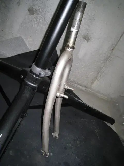

Hi, wanted to revive this thread in hopes that someone can identify the frame and/or fork.
I've updated the pics with new ones I have just taken.
re-weighed the frame and it is approx 4lbs, 9oz/2.05kg
fork is approx 1lb, 10oz/740g

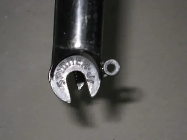

in comparison, the joe murray project two forks weigh in at approx 2lbs/950g

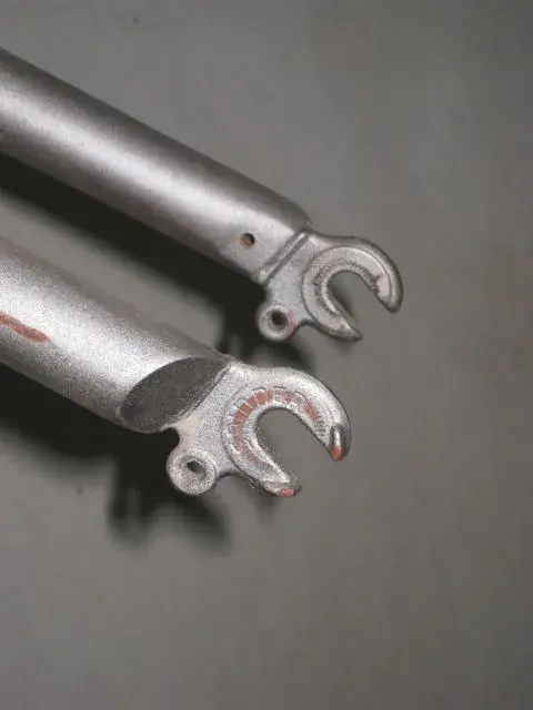

the mystery forks also has the similar "spinner" embossed dropouts as the p2 forks.
i've also made some measurements of the frame. it's approx 18" bb to top of seat tube, 22" from center of seat tube to center of head tube, 17" from center of bb to center of rear drop out.

The serial number screams Universal Cycle a mainland China joint venture factory that was started by Dodsun of Taiwan. Dodsun built for lots of companies over the years and in the 94-5 era a lot of their customers took their entry to mid level bikes to Universal in China to save 5-7 percent to either make more profit or price their bikes more competitively. If memory serves me correctly 1993 was the first year Dodsun pushed us to take our entry price point models to UCC and I think that was the first year the plant was up and running. I chose to stay in Taiwan not wanting to risk any quality issues although the UCC plant has always been among the best Mainland facilities.... well run with excellent management. Rear dropout has rack eyelet holes which says mid level to me. Who used a dropout like that??....anybody recall. Fork end also suggests a mid level fork...but with that fork weight it's light for a BIG bladed fork. Seat Post size may also help with the ID. as well has the head tube size...what are they? Diameter of the top tube, seat tube and down tube may help also. Not sure if it's just the bare color but it looks like OS tubes. What size Front derailleur clamp does it take?
I think the shadow is making the top tube look fatter than it really is - it seems to be a 28.6, with a 28.6 seat tube and a 31.8 down tube. As GM says, you can learn something from the post size - if it'll only take a 26.4 post it points to a thick tubewall, the bigger the post it'll take, the thinner the tubewall and the higher the implied quality.
The weight is consistent with a mid-level double-butted frame, say more like a Hammer than a Blizzard. The fork weight is comparable to the lightest triple-butted P2s, whereas the 950g you quote is for a plain-gauge P2.
So it's all pointing to a good quality frame - certainly not trash, not the highest either, but its value would be enhanced by knowing its name!
