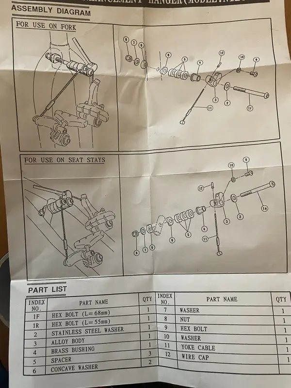

Does the shoulder on the bush not provide a bearing surface and also set the linear clearance for the cantilever pivot?
I’ll take a picture of the instructions
Thing is - this was £5.99 inc postage so not a big deal

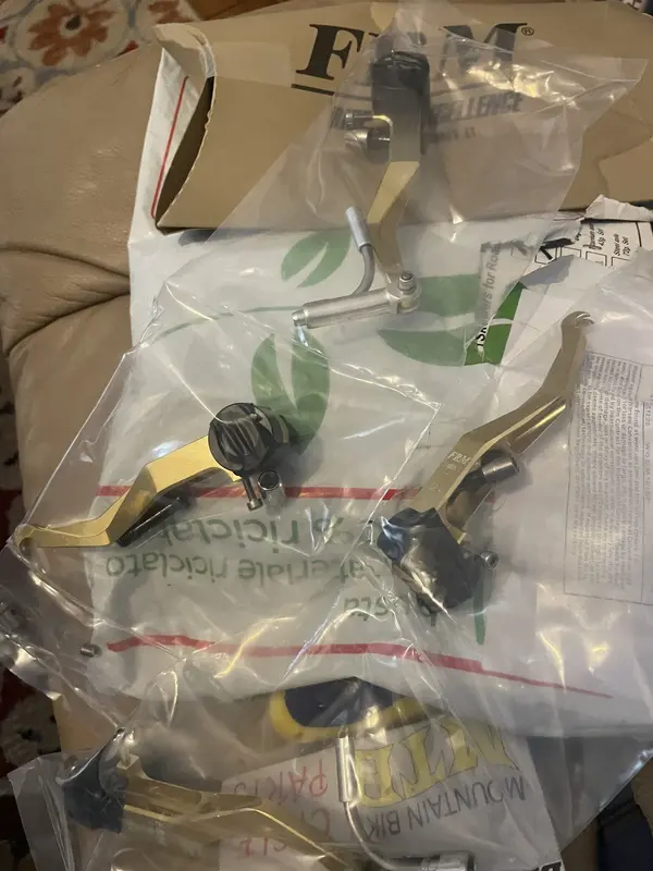

Alternatively I could just forgo cantis and use V Brakes - I’ve some FRM DP4 and with a ‘travel agent’ I could use the FRM canti levers with them.
Here’s the schematic / instructions FED3AF90-BF12-432D-9EE2-EC122C8D62BF.webp
I think you should definitely use the canti's and dispose of those awful FRM DP4's in my direction! 😂
Not a huge fan of travel agents both functionally and aesthetically but they do achieve a purpose. Had them on a folder with road brifters and v's and never loved the set-up.
Great idea - send me your address and I’ll post these hideous things out immediately 576D9691-D345-437F-8DB6-34C27D4ECE09.webp
But you’re right - the look with the travel agents or even the flash looking Tiso P-Pue would be OTT on an older slim frame like I’m fitting up
