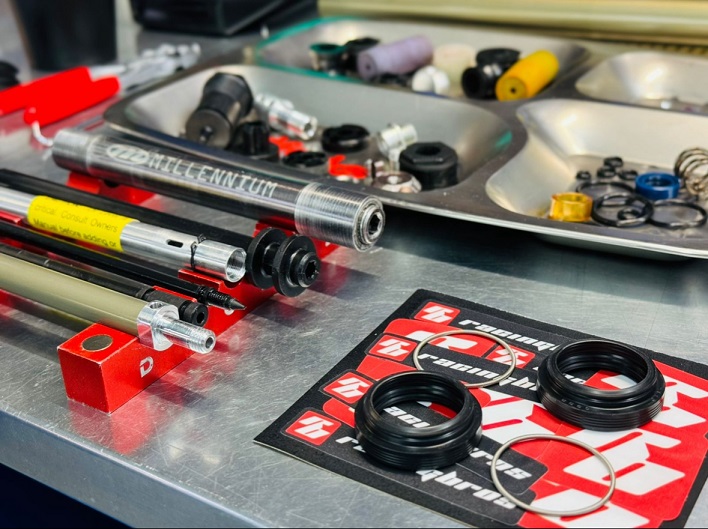

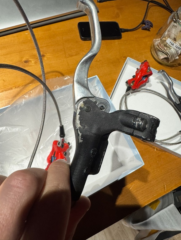

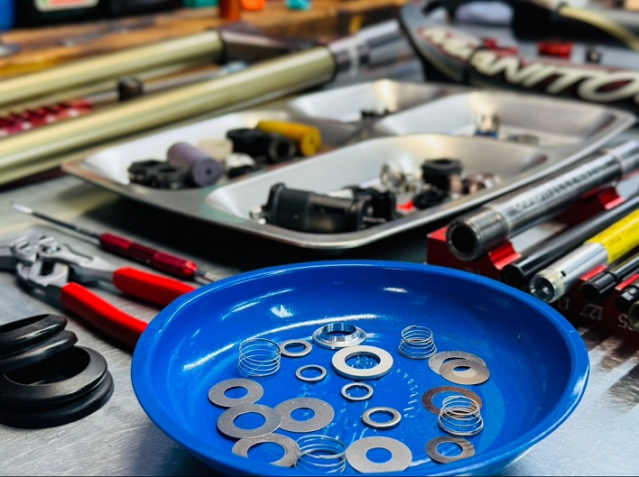

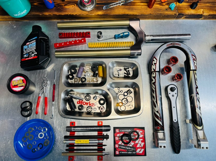

One gloomy snowy evening, sitting in my crumbling hovel, on the 78th floor, with an outside toilet. I was sipping vodka from a tub with my tame bear, both snacking on turnips. And I had the idea to build a good bicycle for the clubfoot. But how can I do this? While these are troubled times. Our dear country is oppressed by overseas foes with villainous sanctions. So much so that all foreign merchants have abandoned holy Rus'. Ebay does not want to accept foreign overdrafts from our country. SWIFTs have all been disconnected for us, and McDonald's have taken away. I wiped away a tear with birch bark, and thought, I'll scrape the bins, tea, and dig up something. Due to the fierce disaster that enveloped the Russian land in damned wickedness, I scraped together only enough money for an old Foes Zig-Zag. I got a Manitou Millennium fork out of my bins. I put a Chris King NoThreadSet steering wheel between them and screwed everything together with a titanium bolt, planed by my compatriots. The cockpit is assembled in the old-fashioned way on an Azonic PDW and Shorty. The Race Face North Shore DH system took its place with a RooX RollerCoaster World Cup chain guide, kind people from neighboring villages on the outskirts of our vast country helped. I had to assemble the wheels - Mavic DeeMax 2004 - a real joy. I patched up Tioga Factory F+R tires of size 2.1 on flax, and without your sealants, but with native rubber tubes from maxxis. The soft place will add comfort to the Tioga saddle, also handed over by the Soborny brothers. The transmission is assembled on the basis of XTR, LX and Sram PG990. The 4-piston Grimeca Sistem 8 are responsible for braking.

Fork - Manitou Millennium

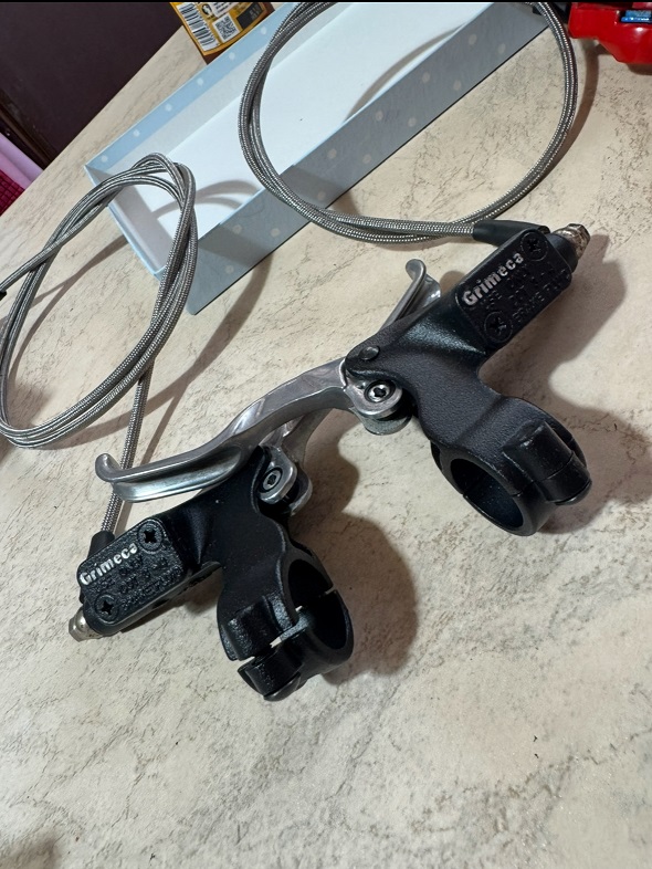

Brakes - Grimeca Sistem 8
Rotors - Grimeca 180/160
