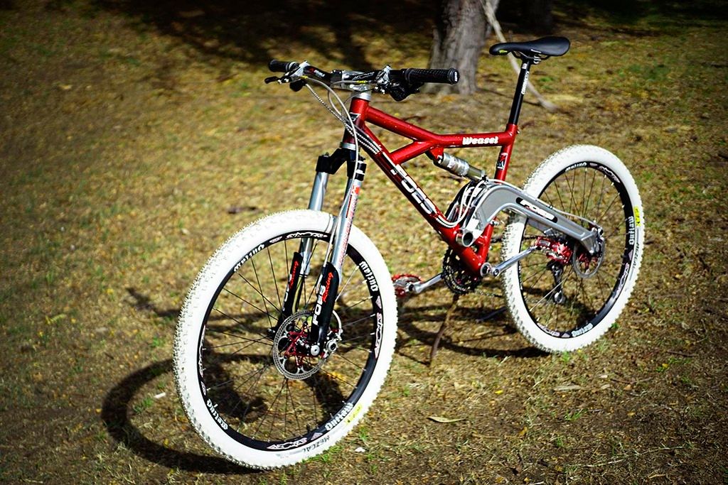

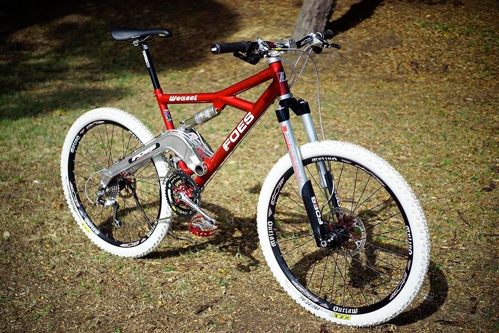

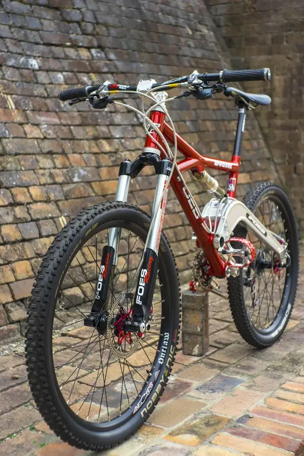

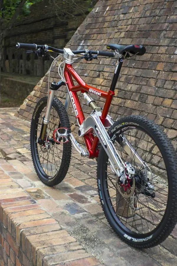

Finally finished :)
Powdercoated by in red candy flake. Modified it to run disc on the rear to go with the shivers up front. Running hope x2 with Goodyear hydro lines and ilink gear casing. Top line cranks on there too. Amazing ride with the 120s up front, leaves a lot to be desired in the modern rides I have. They're vanilla, this is definitely another flavour :)
Final build but unfortunately have put up for sale...
http://www.retrobike.co.uk/forum/viewto ... p;t=358765
Link to photo gallery
http://s1370.photobucket.com/user/donny ... FOES/story
FINAL BUILD SPECS:

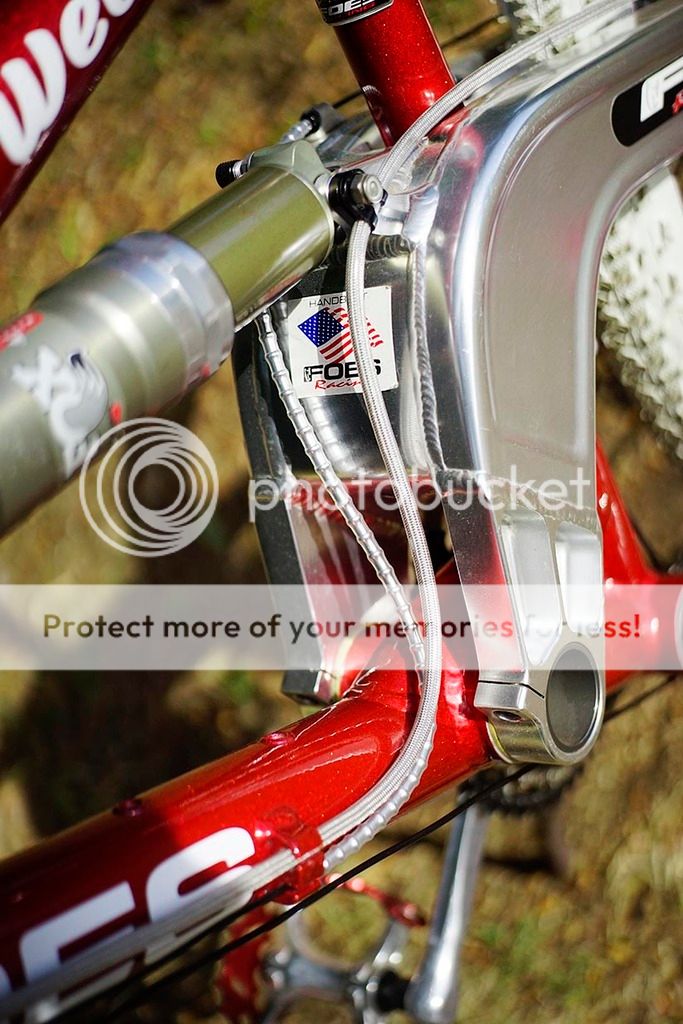

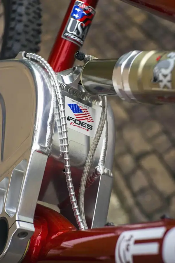

Frame
Details: Disc mount and replaceable dropout modifications
Colour: Fire Engine Red - Candy metallic. Custom Colour by Robertos.
Suspension

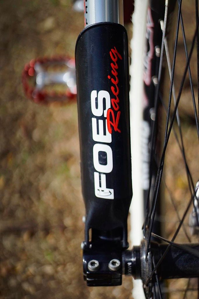

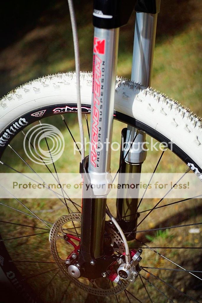

Fork: Marzocchi - Team Racing - Shiver UST - 120mm
Rear shock: Fox ALPS 5
Controls & Seating

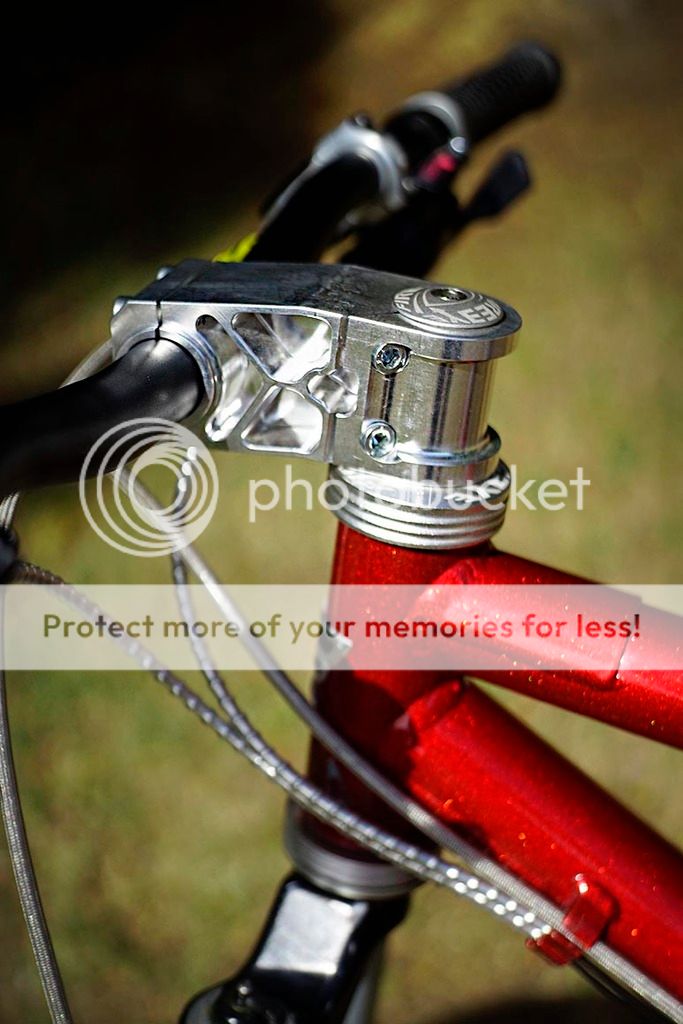

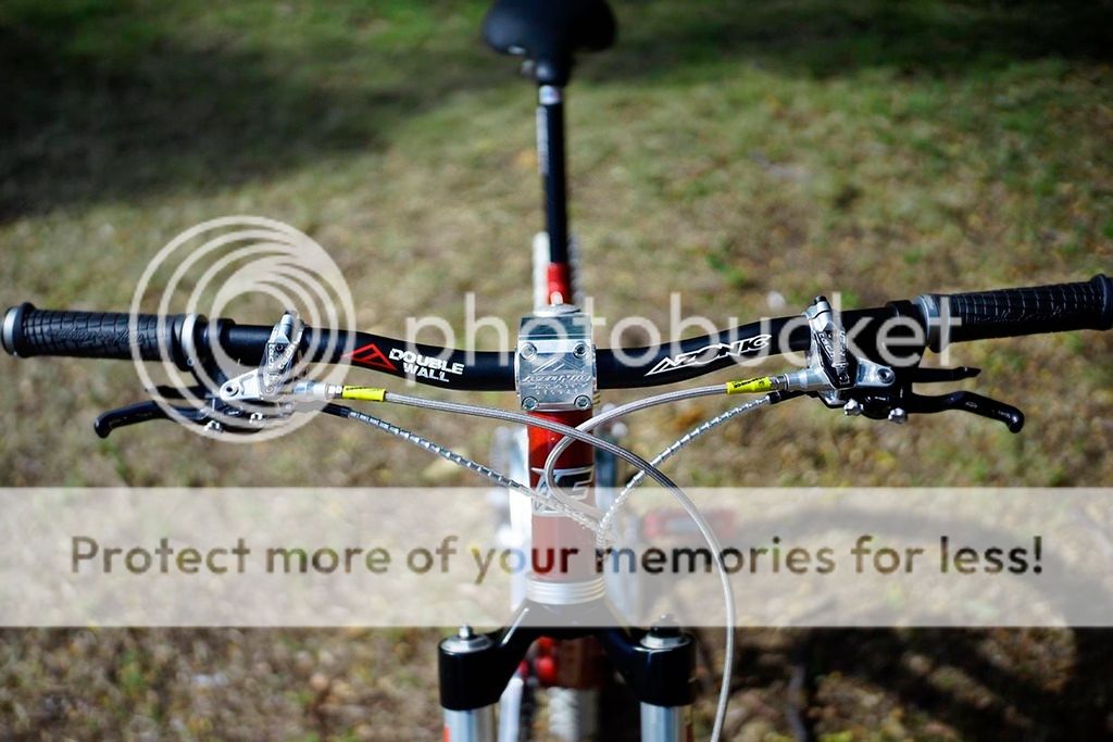

Handlebars: Azonic Double Wall. Rise 25mm, Width 720mm
Headset: Fireeye - Iris
Stem: Azonic - Shorty
Saddle: Flite - Titanium
Seatpost: Control Tech - 26.6mm
Grips: ODI “Troy Lee” grips and bar ends
Pedals: VP Beartraps - Red anodised
Brakeset
Brakes: Hope Tech X2 EVO with Goodridge braided Hose & fittings
Adapters: Uberbike Components - Red anodised
Rotors: Uberbike Components - Floating 180mm front / 160mm Rear
Drivetrain

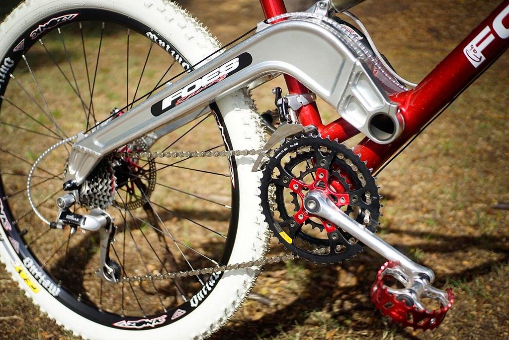

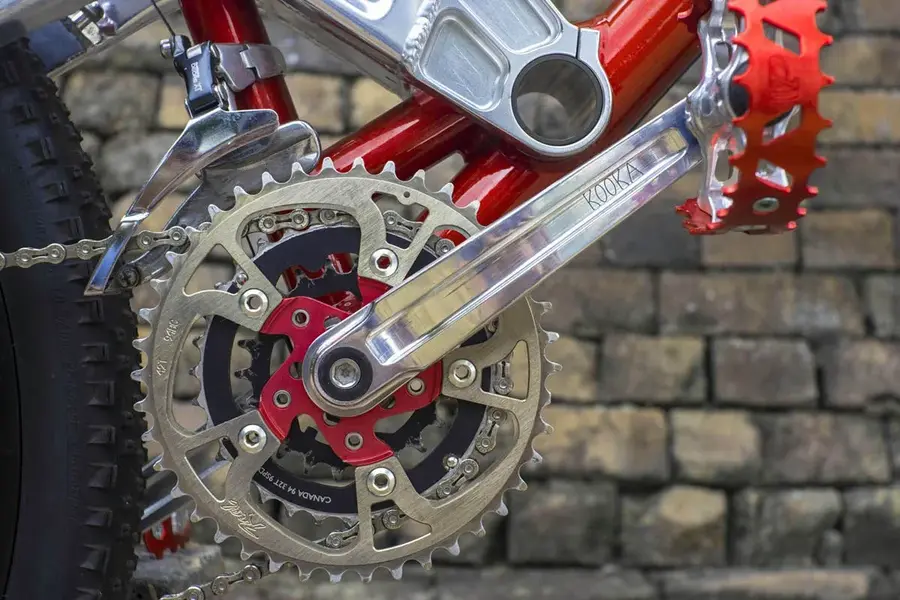

Cranks: Kooka - Polished Arms / Red anodised spider
Chainrings: Real, RaceFace, Shimano
F derailleur: Shimano Deore XT
R derailleur: SRAM X5 with red anodised jockey wheels
Front Shifter: SRAM X7
Cassette: SRAM 11-32
Shifter Cable: Alligator iLink - with Interlink aluminium outer and PTFE liner.
Wheels
Wheels: Azonic Outlaw
Tyres: Schwalbe Nobby Nic front / Schwalbe Racing Ralph Back
