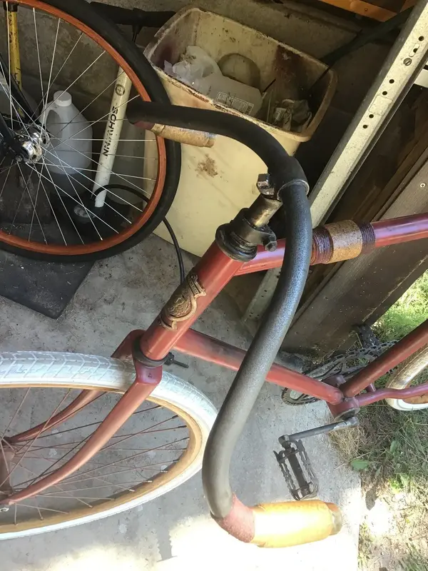

I drilled an tapped for an oversized grade 8 bolt that I ground so a 3/8 wrench fits, as original. If this doesn’t hold I’ll drill and tap a for a bolt that will go through the stem and into the bars. I do this on my klunkers that have cruiser bars as they collapse on the whoop de doos, no matter how tight. A last resort is to weld the bars to the stem. I’m hoping this is it, good enough, perfect, done. C51A6D81-2BAE-41B9-B6B7-2BDF2C5FEB2C.jpeg

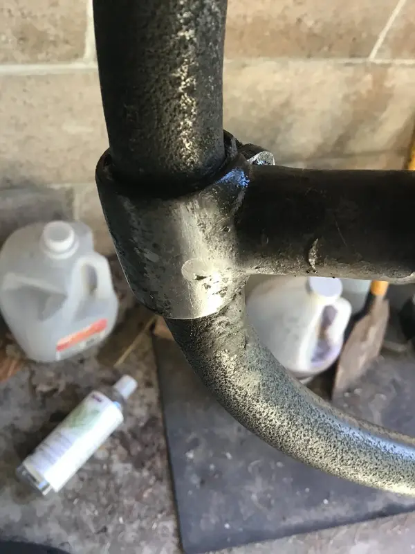

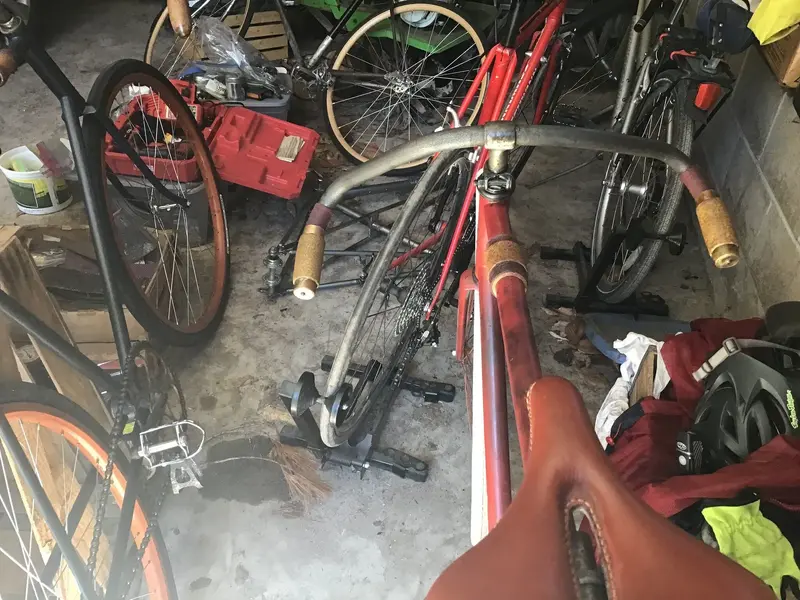

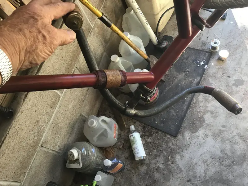

I don’t trust that shallow dead end hole. I don’t want it to let go again when I’m pulling on the bars. Fixed gear puts a lot of strain on the bars. I drilled through the stem and the binding collar on the bars, threaded it, cut off a bolt with a screwdriver slot cut in it, tinned it, screwed it in while putting solder on it, screwed it counter sink in and soldered the counter sink area in. I then sanded it flush. This should keep the bars in place and they will still be removable with heat. I was going to plug weld the bolt in but then I thought of soft soldering it in. 1CB05E2E-EDDC-4D64-AD89-20D8085DCBFC.jpeg 281C2F7C-3E90-439E-8118-1DFB0A2D4887.jpeg
You can’t see it when the bike is upright. 7E46DF2B-3779-40A9-B4DC-6D8E7795599F.jpeg
